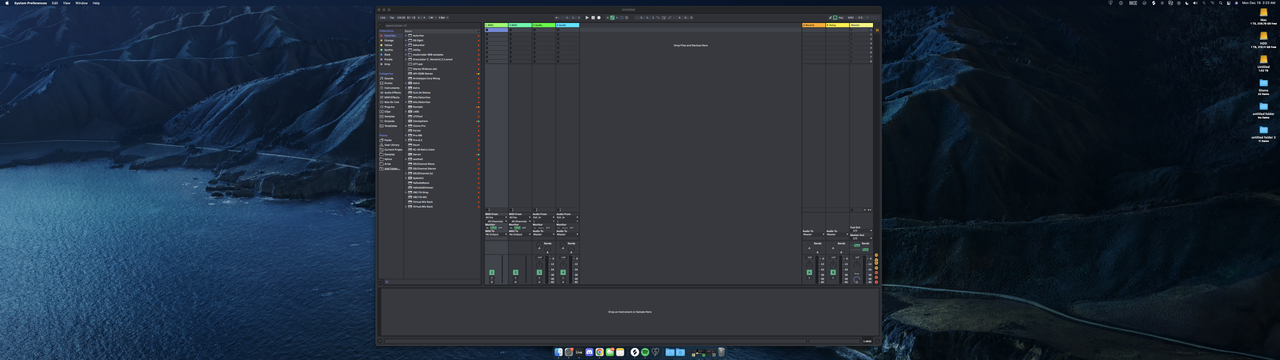

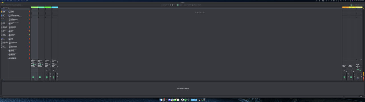

Hey all,
I've recently upgraded to a 49" 5120x1440 monitor. I used to have 3 1080p monitors. Everything was working fine until I upgraded to the bigger monitor with a higher resolution.
When I have a program such as ableton or discord open with a small window, the audio is fine.
However, when enlarging the window, the audio will start to drop/stutter.
The problem occurs with the onboard audio and also with a usb interface. Everything was working fine until I used a monitor with a higher resolution. Surprisingly it doesn't happen with google chrome.

I don't think it's due to the monitor but it's due to the resolution of the applications.
Yes the problem goes away, but that's because the resolution/window size of the application is smaller. The ultrawide is fine as well when the resolution/window size of the application is small, but when I stretch the application, that's when it starts to lag.

Last statement is somewhat incorrect.
Google chrome works perfectly full screen. There are some apps that have the same behavior as ableton, such as discord, telegram, or screenflow. It depends on the application. Those 3 applications exhibit the same behavior as Ableton.
