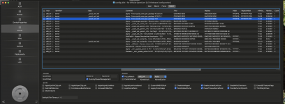

Kernel-Patch 12 CORE:
Please, what about CPU patching? I have AMD Ryzen 9 5900x 12 Core CPU, is my Config.plist properly configured for this CPU?
From the recent AMD CPU patch, now we have to specify the CPU core counts to the algrey - Force cpuid_cores_per_package nodes.
12-core CPU model - OC
looks like:
  • algrey - Force cpuid_cores_per_package
    • 10.13,10.14
      • B80C0000 0000
    • 10.15,11.0
      • BA0C0000 0000
    • 12.0
      • BA0C0000 0090
use OpenCore Configurator for editing config.plist - or PlistEdit Pro. But OpenCore Configrator is better for understand it.
BA0C0000 0090

The CPU patching is fine in your original EFI and in the one I provided. The patches in both config.plist's were set correctly for your 12-core CPU.
Monterey 12.3 will boot just fine on your system with OC 0.7.8 and 0.7.9, you don't need to be using the beta version 0.8.0.
