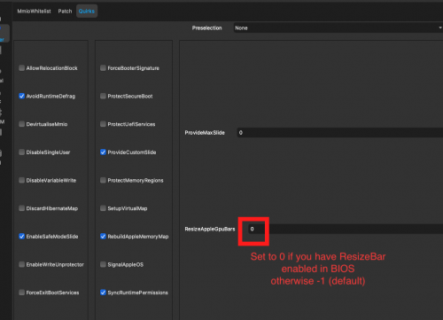

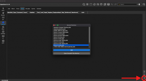

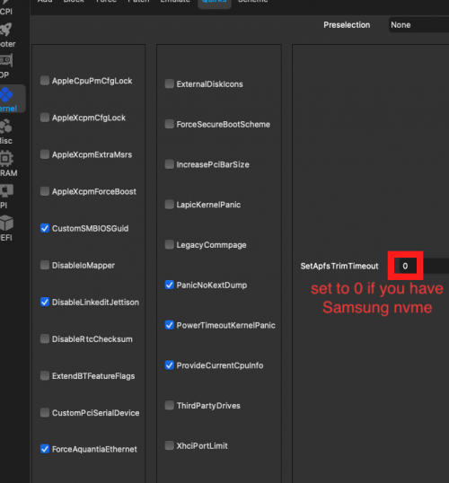

I have this build too. I saw your efi and I think you have to update your kernel patch...
I solved the problem using OCAT.
I also saw that you have kernel quirk "AppleXCPMForceBoost"... why?... use this settings below and let me know
