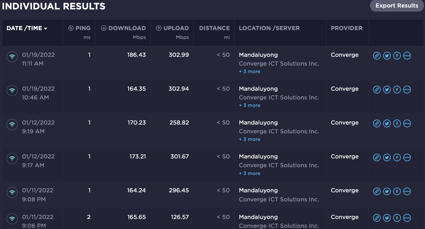

  • Intel NIC211 Lan (SmallTreeIntel82576.kext, slow speed maxed at 160Mbps over 300Mbps connection)
  • Kernel patch to get Higher FPS on 5700XT GPU. (Shaneee - _mtrr_update_action fix PAT - 10.13/10.14/10.15/11.0/12.0)

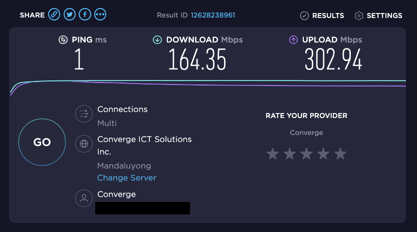

Internet speed test results:
  • Mac = 160Mbps+ (iperf3 to rounter through LAN is 940Mbit+/sec)
  • Win11, Linux = 268Mbps+ (iperf3 to rounter through LAN is 940Mbit+/sec)

Yes Shaneee, checked all the settings, replaced the cable. Im still getting slower connection on Mac (160Mbps) as compared with Windows, Linux (280Mbps+), Im on 300Mbps Fiber internet.
Never mind, I can bear with it, 160Mbps is pretty enough for the normal online stuff.
Thank you Shaneee, downloaded and updated in the kext driver folder, will reboot and test it.
Reboot -> Resetted nvram -> Reboot.
Got 20Mbps increased.
