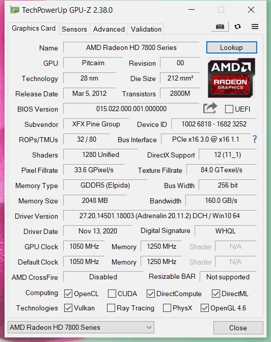

How confident are you in BIOS flashing the card? I grabbed a XFX VBIOS for the 7870 from TechPowerUp and I've modified it for UEFI if you're comfortable with flashing it. There's no guarantee it'll then work on Big Sur though.
I have no problem flashing the bios on the card. As long as it lets me disable CSM on the A520 motherboard it has to be worth a go.
2,168
It should do. Save a copy of your current VBIOS first. This bios simply has GOP added to it.

I did check my card spec:

I was sure I'd attached one lol. Save and upload the one from your card just to make flashing it back easier. I'll add GOP to yours.

Ok, I think I have done this correctly?
  • bios.zip
2,168
  • bios_updGOP.zip
2,168
I flashed the bios and the card is still working so that is a plus :) I will now try with the A520 board and let you know how it goes.
GPU-Z should also report its UEFI now.
