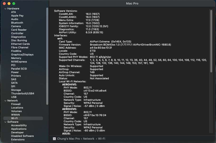

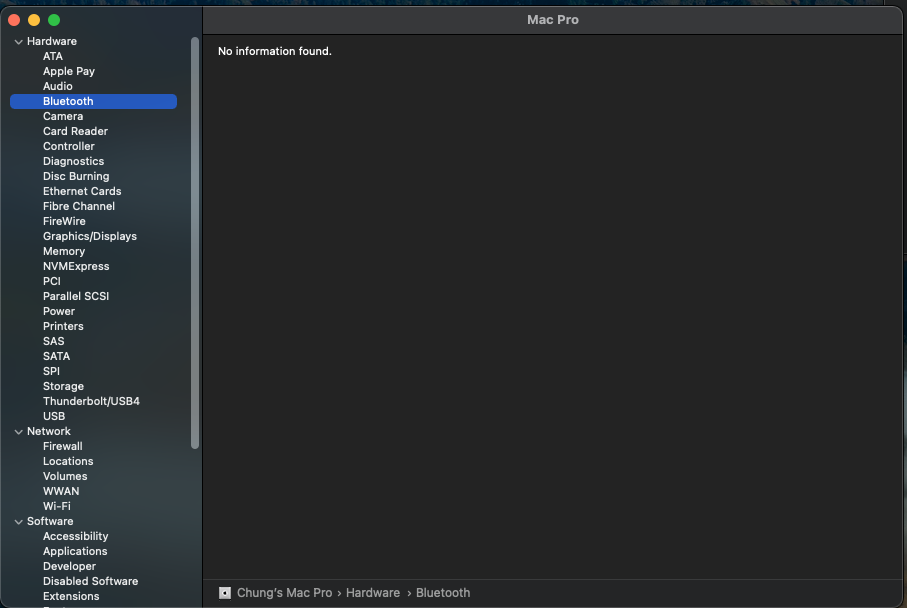

Hi @Shaneee ,
Thank you for sharing the files to successfully install Hackintosh.
But now I am suffering from a problem with using bluetooth. Looks like it's not working. I also use wifi card and adapter like yours.
Can you share a picture of the connection wire from the wifi card to the mainboard. I need to know for sure where to plug in the internal USB ports. Maybe this is the problem.
I tried running on Windows 10, both wifi and bluetooth work fine.
Thank you very much.
@daovietchung It should work in either of the two USB 2.0 headers on the bottom of the board. I'm using a NZXT hub as I needed more 2.0 ports.
I have tried both USB 2.0 headers and neither of them work. Probably needs to be remapped.
Try with this kext,
