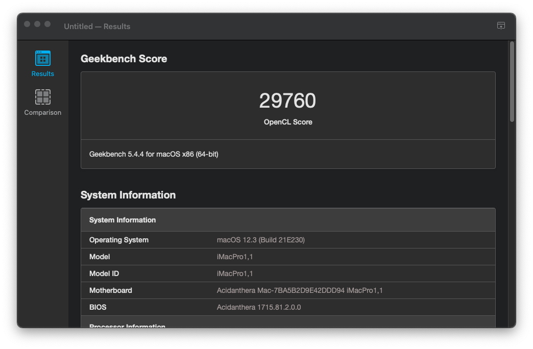

clover84
May 16, 2021
42
It seems like I've found a solution to graphical problems. I have a Radeon Pro W5500 card, but it's not a card that comes with Mac Pro. They do have a W5500X though, so I just spoofed my card with an X one in opencore. Now it's smooth. The only potential issue I've noticed is that the fan doesn't spin up under load. Not sure if it's normal behavior, but in the past I clearly heard the fan spin up when working in Figma or rendering with Blender. The card isn't getting very hot to the touch though.
UPD: seems like W5500X has a different cooling profile, thus a different fan curve. When "idle" (not under heavy load) the fan doesn't spin at all. Under load it gently ramps up, but doesn't reach even 50%.
UPD2: fan speed doesn't change even when I'm hitting 92C. Not good.
UPD3: figured out the fan speed. Had a custom curve in Device Properties, surprised it even worked. Removed the string, and the fan is back to normal behavior.
