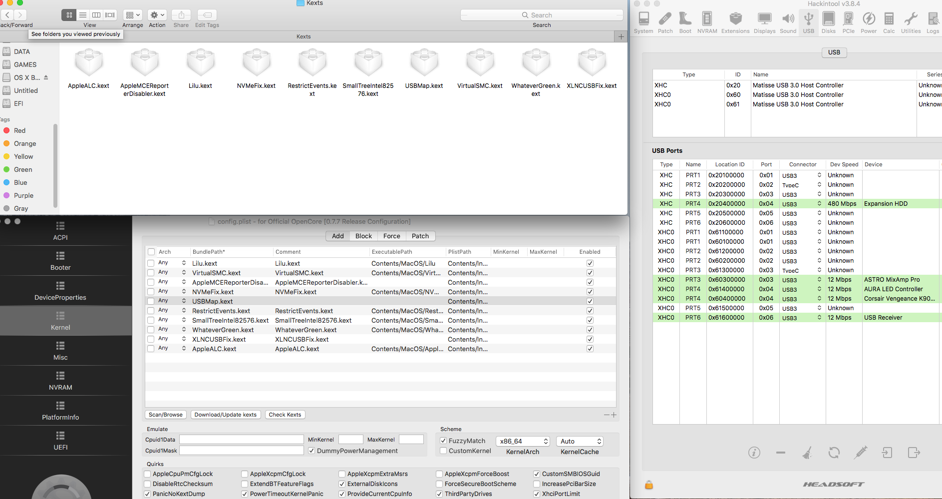

and this screen was literally took 2min after the fresh install was done, just the time to redownload open core configurator, hackintool and IOReg I didn't used any additional kext or patches that was not included in your last EFI folder, didn't map anything the os is as fresh as it can be still I don't see more than 16 ports. god damn

I'm on my way to redo the port recognition thing and will add to comments if it shows usb3 or not
also a strange thing is when I plug a known usb3 device into usb3 port it shows only 480m/s but not higher ?
will post the screenshot in 5mins

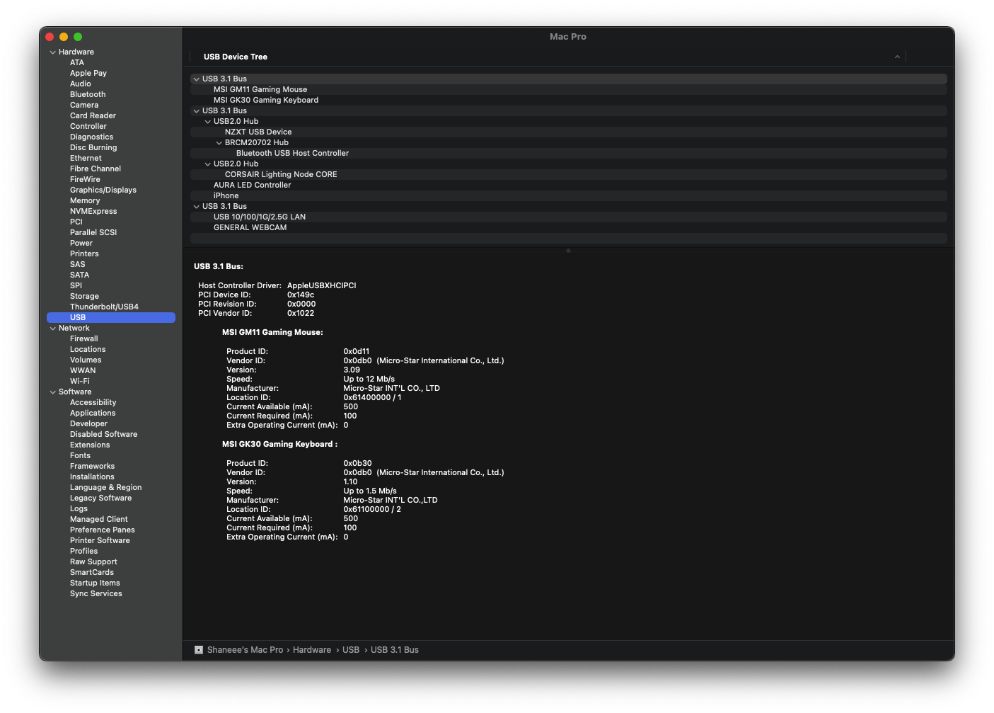

I've not had any USB related issues on this board no. Even the NZXT USB 2.0 hub I have connected to one of the 2.0 internal connections.

It's messy but it works 🤷‍♂️ This is the map my system uses, give it a try.

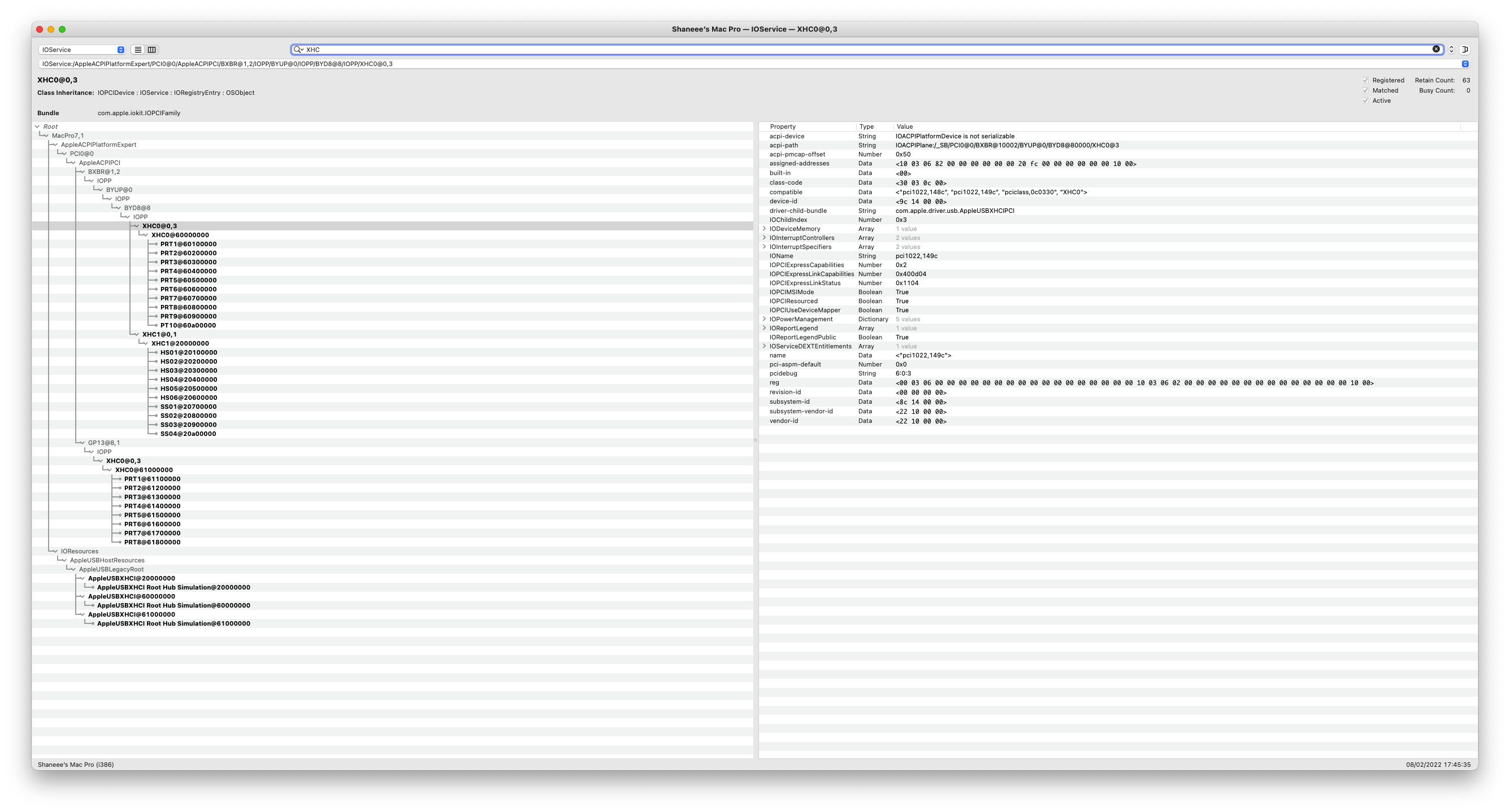

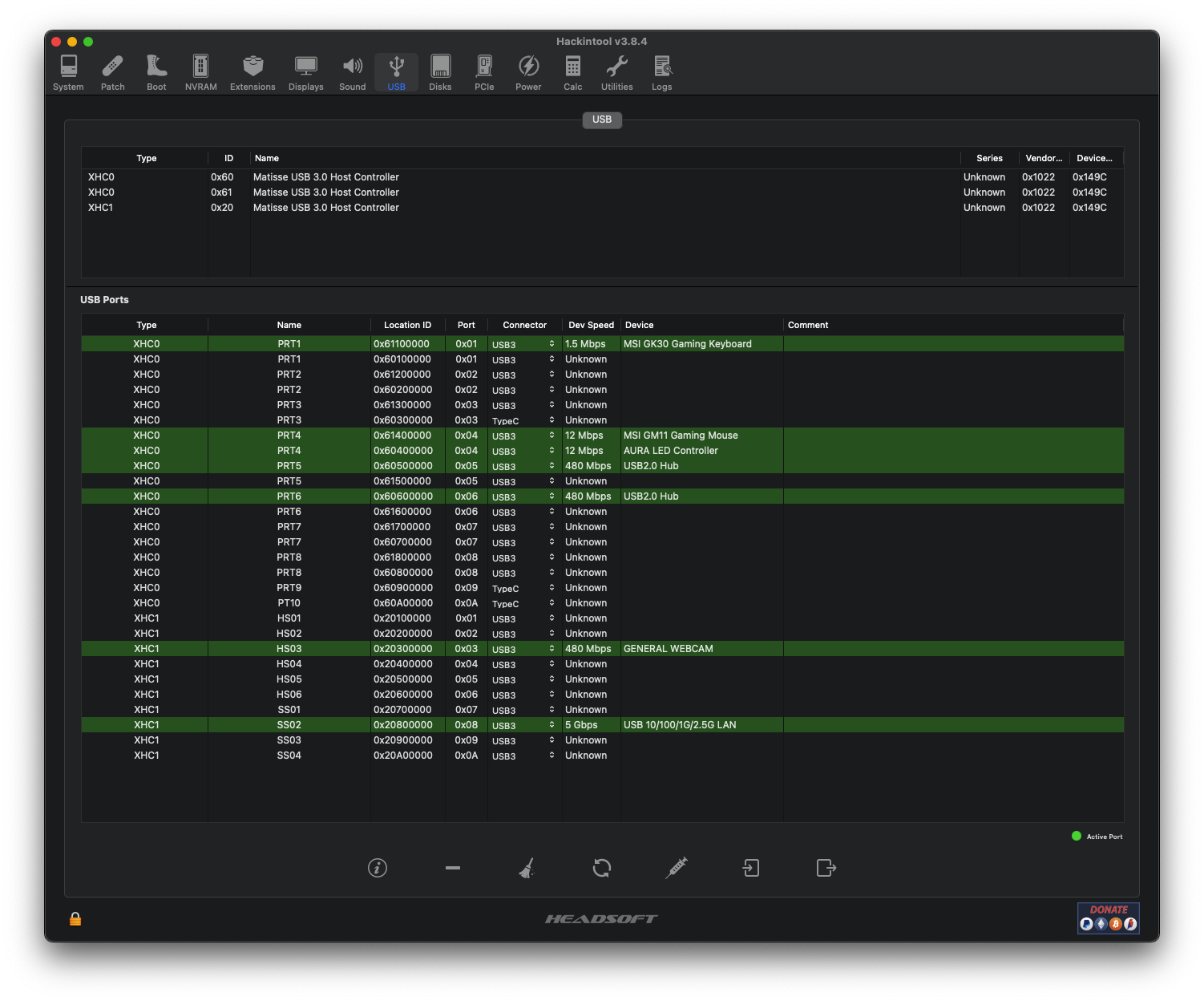

If you have 10 secs can you please post an IOReg and a screen of the usb section of hackintool ?

Hackintool isn't very accurate I've found for USB. For example below it doesn't show any of the internal stuff but System information does as you'll see in my earlier screenshot.

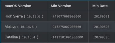

Download and install Catalina or an early version of Big Sur (prior to 11.3) where the XhciPortLimit quirk works.
Then map your USB ports.
Having XhciPortLimit functioning should help.
Ditching the MB is not wise. You could easily end up with the same issue, using another MB.
You have an EFI that works, so half the battle is solved. Create a USB installation USB, with the CreateInstallMedia terminal command, so the OS restored to the USB, not relying on the Internet Recovery method.
You would need to change the UEFS > APFS > MinDate and MinVersion entries if you were to install Catalina. But other than that is should all be the same.
Screenshot 2022-02-08 at 20.27.14.png MinDate & MinVersion entries for older versions of macOS that use APFS formatted drives.
