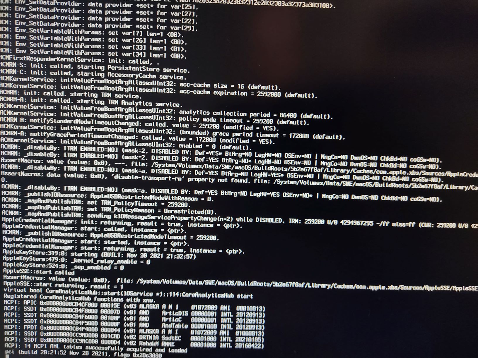

Followed this guide https://github.com/mikigal/ryzen-hackintosh
Mapped my USB Drives
Am having a kernel panic
Any help would be most appreciated!

You had missed the core_count kernel patch for Monterey. Should work now.

Remove the SSDT-CPUR.aml file from your config. This is for B550 boards and most likely causing the issue. @stotes
2,190
Ahh ok didn't know, topic title is B450. In that case keep it there. The issue is MSI on Monterey.

I just tried without the CPUR AML file, no luck just gets stuck here
I just remapped the USBPorts and will try again with the CPURAML

Is Above4G still set in the BIOS? Also try removing the vsmcgen=1 arg.

It wasn't enabled which is odd because it worked before without Above4G running 5600.
Removing vsmcgen=1 failed as soon as it gets through ACPI.
With Above4G enabled, ResizeBar disabled, vsmcgen=1 it gets further however fails after
AppleUSBXHCIPCIO: AppleUSBXHCIPCI::start: failed to create interruptSource
Below is an OCR of a photo taken when it fails.

Looks like its a PCI issue. The same issue a lot of MSI owners are facing. The extra PCI lanes look to be the issue here unfortunately. You can test this by booting Big Sur which should work without issue on the 5900X.
