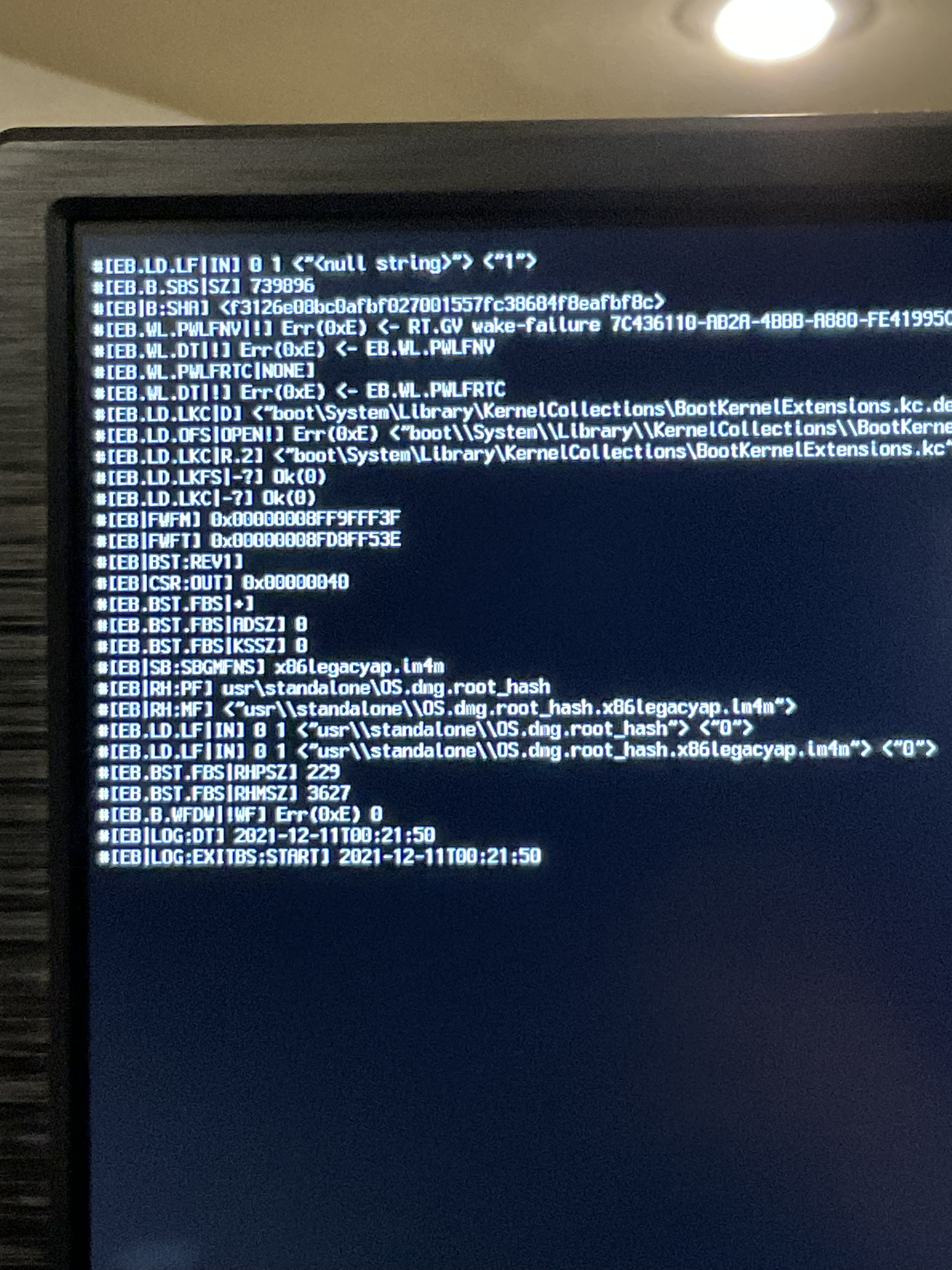

Thank you, I swapped out my config.plist for yours and it hangs at this..... (I reset nvram when I tried booting from it)
2,186
ProvideCurrentCpuInfo needs to be set to True. Its under Kernel -> Quirks.

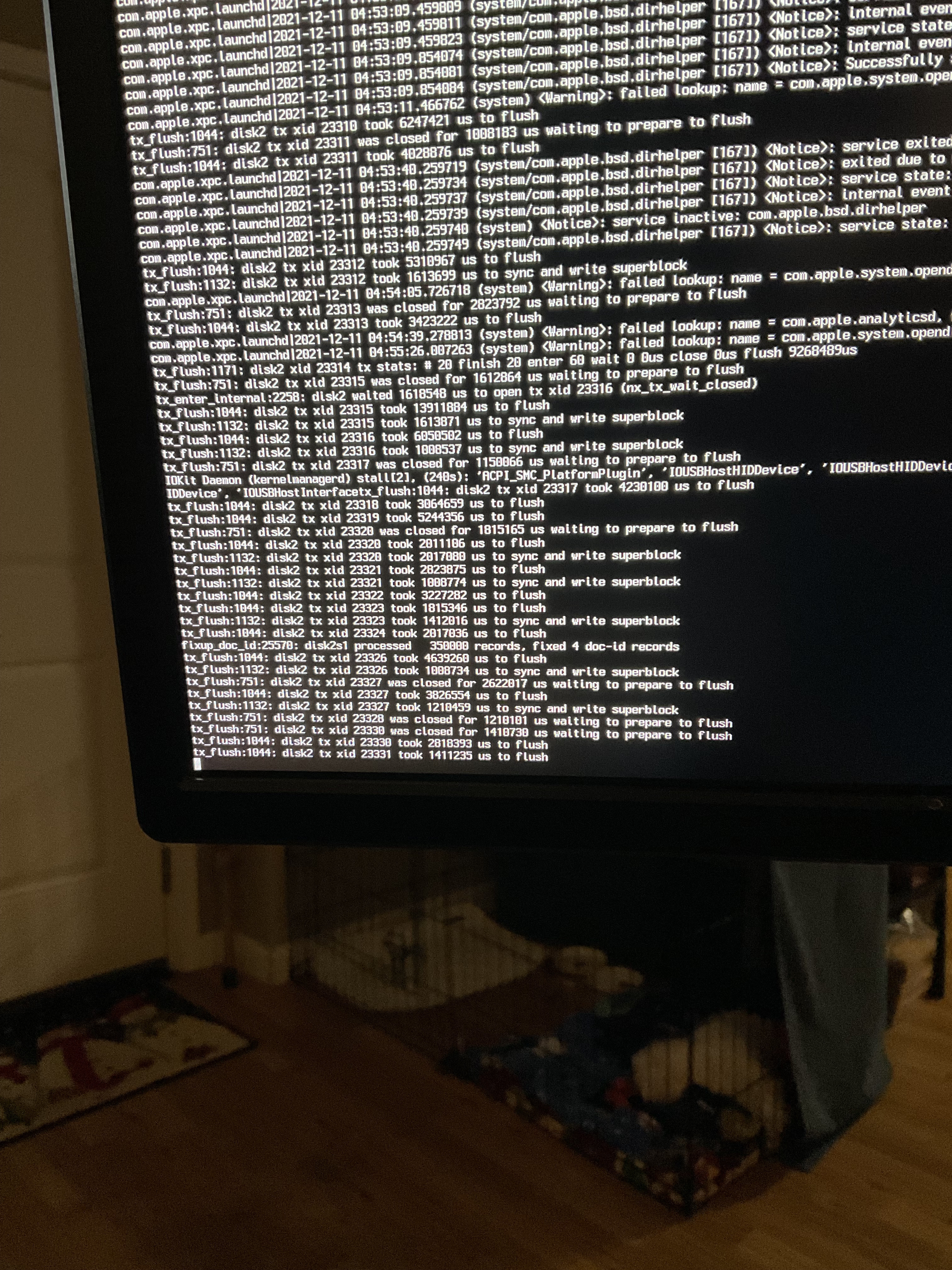

I made that change and was able to boot with the new patches into Big Sur, I did notice that the CPU Info Says Unknown CPU (Dont know if that matters) so I decided to try the Monterey upgrade, it rebooted and it seems to be stuck here, moving one line about every 15 seconds. It has been here for about 1.5 hours. Any ideas?

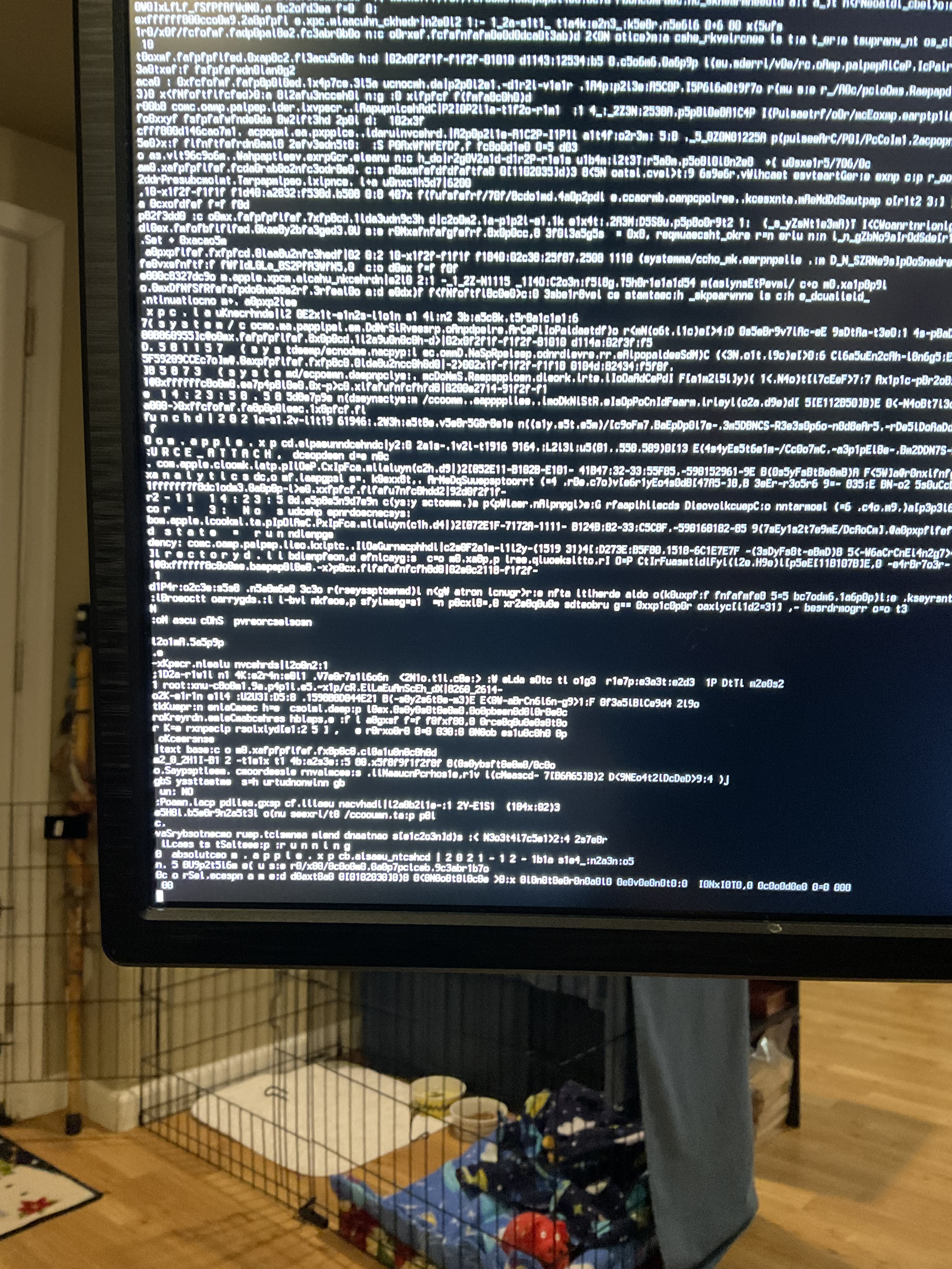

Disable the XhciPortLimit kernel quirk.
Ok, I did that and it halts at this..... (I also went to reload Big Sur onto the machine just now and it says I cannot downgrade and shows 4 snapshots of 12.0.1 so could this be a video issue? I have a RX 580 8GB

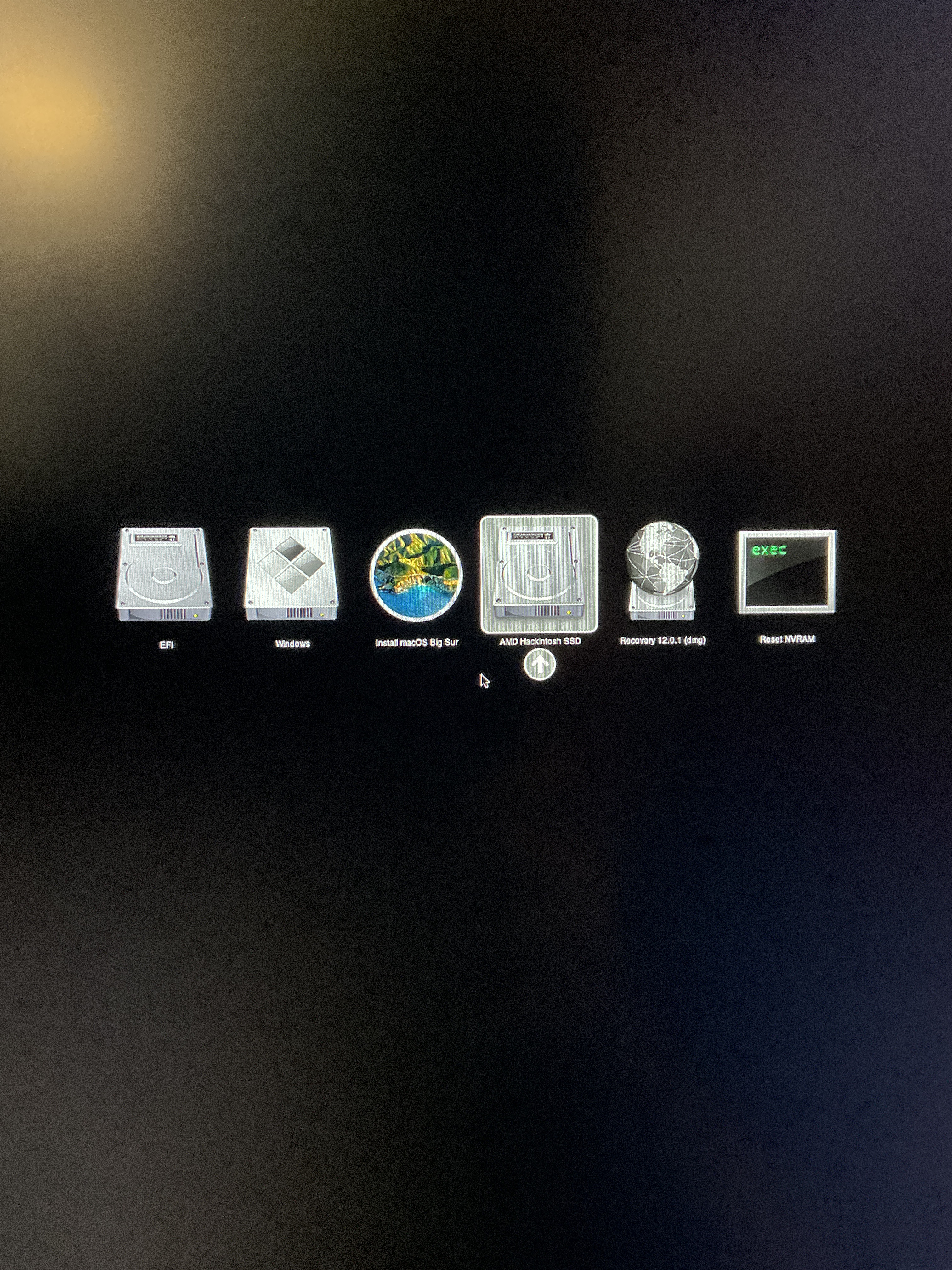

What does it show in the boot picker?
I've never seen a screen like that...
This is what shows, the Efi is a usb drive along with the install Big Sur. The windows is on a second nvme ssd. If I select the AMD hackintosh ssd I get that freeze I uploaded.
2,186
Try booting the Monterey Recovery that's there. Then install Monterey again. It'll keep any files etc.

It's possible but I don't think it's an issue. It looks like macOS just tripped out and spat everything out garbled. Not seen anything like that since custom kernels were used.
It's also possible that the installer/system just got corrupt somehow.
