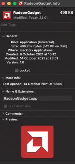

@Aluveitie Here's a icon for your brilliant Radeon Gadget. It was doing my head in seeing a blank box in my applications... :)
  • Radeon.ico.zip
895
@AudioGod I already added the same icon on latest master 😂

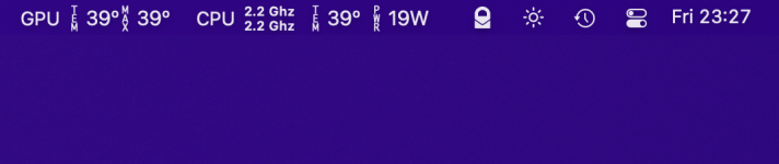

2,186
Would be awesome if there was an option app or Addon similar to the AMD Power Gadget. Sensei can pull the clock speeds etc from the card, not sure what it's using to do so though,
895
Yep, that would be a long term goal. It is documented in the Linux Kernel how to read those stats. Would be doable on MacOS as well, just have to figure out how to properly do it.
