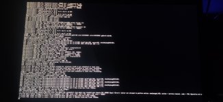

also there something in Device properties
if i add this device_type on GPU APCI root
it will stock on boot blackscreen
never get in os
Cyberdevs
May 19, 2021
52
@Plyman
I think i found out the issue with that. Please try this:
  • EFI 2 - EFI - Device Properties.zip
Polyman
Feb 22, 2022
15
@Plyman
still same stock on boot screen
i did this before many times i extract my gpu pci device from hackintool put device_type VGA compatibile
keep stock on boot won't get os

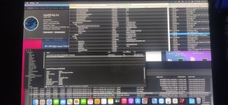

Cyberdevs
May 19, 2021
52
Boot into macOS with the config that works; Use OpenCore Configurator to open the config.plist, navigate to Device Properties and remove all the items in the list and then add all your device properties form the list like shown in the picture.
Save the config and post it here so I can check the address for the display adapter,
