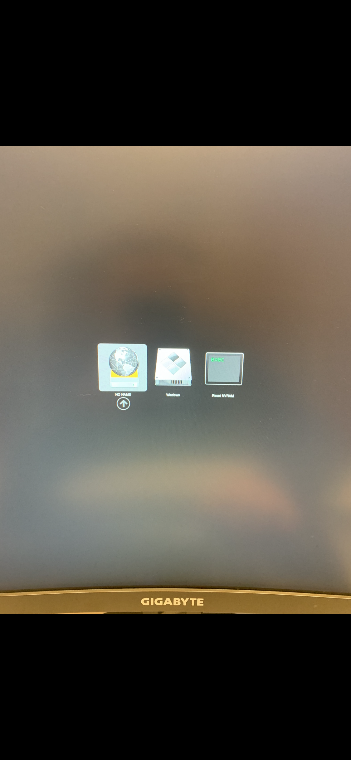

Hey guys.
i have no idea what i made wrong - followed the tutorial from dortania.github.
If i want to boot, i have no option to choose macOS - see pics. scanpolicy is already set to 0.

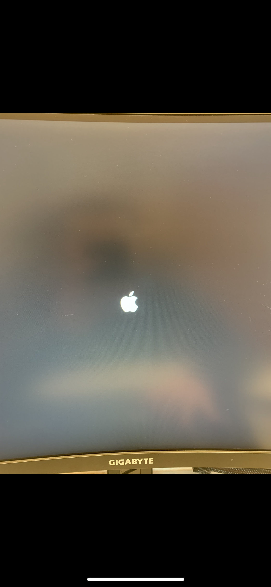

After that I downloaded an EFI for a similar motherboard – the msi x570 gaming plus – and see there appears another choice option.
But unfortunately, the image is freezing on the Apple sign.
The EFI and pictures are attached. Would be great if you could take a look at it for me again.

The icons shown on the OC boot screen above are from a Windows drive (middle icon); what I assume is a FAT32 partition on a pen drive (left hand icon); and the right hand icon is the ResetNvram.efi tool that comes with OpenCore. Although I am surprised it is displayed as the ResetNvram.efi tool is not present in the EFI you linked. In fact the /EFI/OC/Tools folder is not present in the EFI.
You are would need to boot the system using the left hand icon, external drive. Which I assume contains your macOS installer.

FrOdO
Feb 15, 2022
14
Thanks for all that information.
I am such an idiot - i didnt know tonpress the spacebar the whole time. 🙈
Now it looks better. If i press first ClearNvram -> ResetSystem -> Install dmg then there is the freezed Apple logo again.
If i press first ResetSystem -> ClearNvram -> Install dmg then i get some errors.
