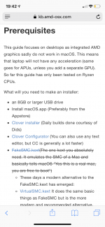

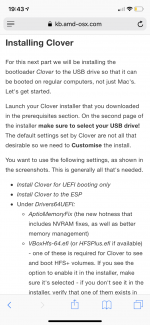

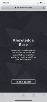

Hi Shane, my friend Im using the Amd Os X guide, I will send screenshots and link
Im very gratefull for your feedback 🙏🏻☺️
and Im fallowing with very much atention and dedication, But in this part Im blocked because my motherboard is legacy only, I will send inagens too, this link https://kb.amd-osx.com/guides/HS/preparing-the-installer.html

2,183

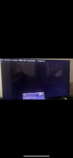

Hi Shaneee my friend do you can help me please?? I already fallow step by step in Dortania guide but don't work unfortunately, I don't understand because, I do all the process fallowing legacy steps, but when I do the boot my pc to start charging but stay freeze, in the begin I receive a flash with the message of image 1, and start charging the verbose, but after the process stop and nothing happens, I can send my efi to you see please, I wish so much install high Sierra in my pc, very thanks for all

Replace your config with this one and try.
