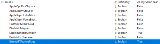

plus add quirk in Opencore:
enable ExtendBTFeatureFlags

1. Add
BlueToolFixup.kext
BrcmPatchRAM3.kext
→ still C6 code (at 2nd round of sleep)

Okay in that case try disabling ExtendBTFeatureFlags and try rebooting.
And if that fails, try to install BrcmBluetoothFirmware.kext and test again.
