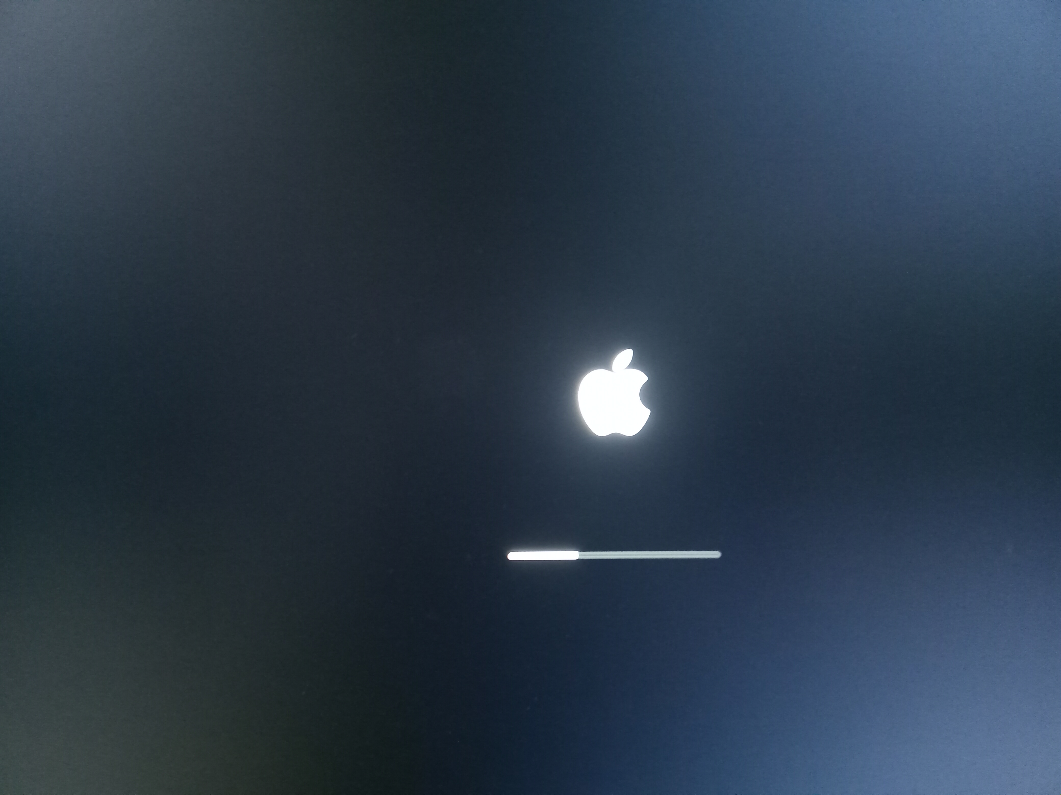

Motherboard MSI MAG B550M Bazooka, AMD AM4, mATX
Here is where the Load stops
2,394
Ok, the B550 board requires a few specific entries in the config.plist which I will look to ensure are present in the next EFI I provide, tomorrow (Monday).

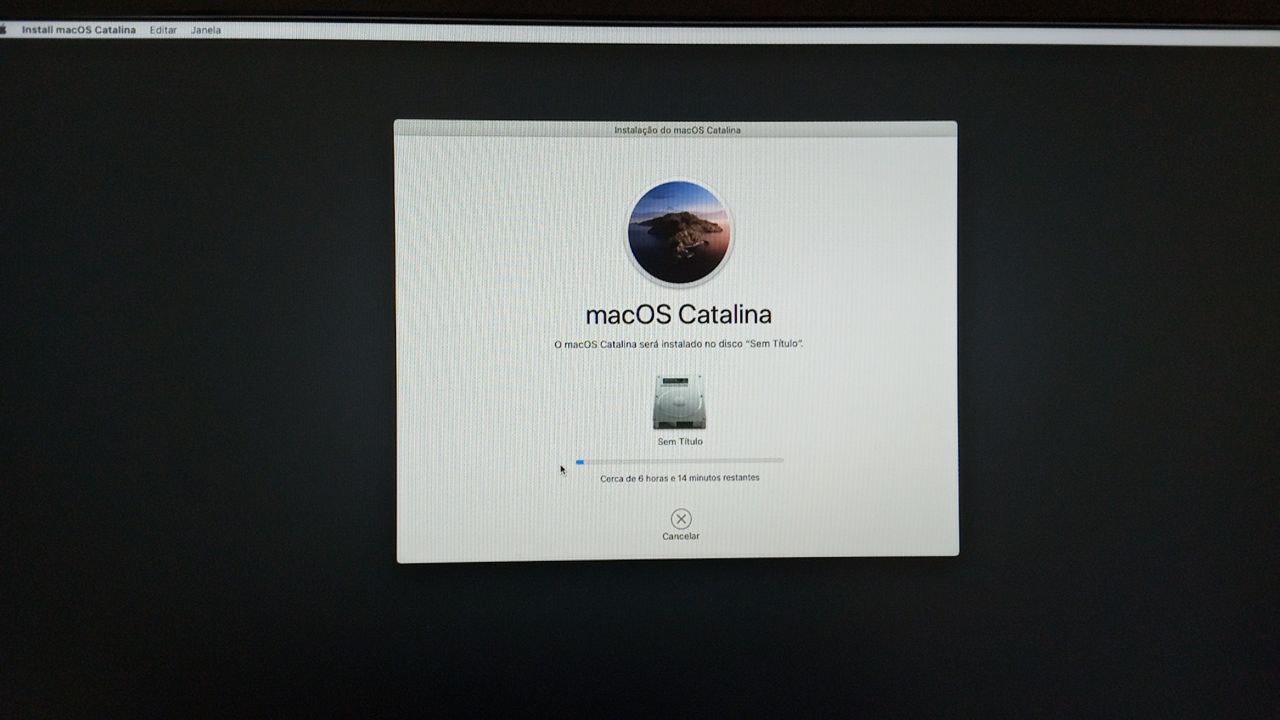

I have made a couple of edits based on your B550 motherboard.
Try this EFI in place of the previous one, see how that goes.
I had to disable 4G. i dont know why i decided to disable it once the tutorial says to enable (in my case) but i disabled and worked fine.
thanks to help-me @Edhawk . you are a friend, my frriend lol.
