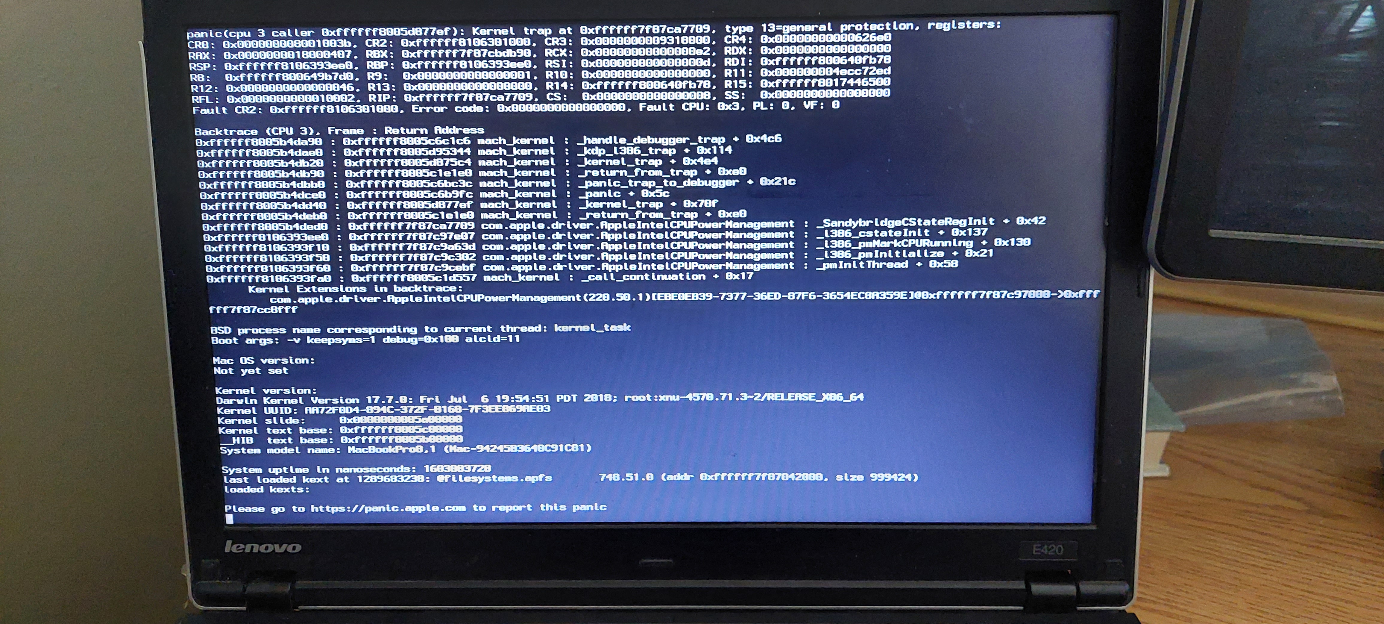

XgamesMFZB
Jan 1, 2022
18
Huh wow - Thank you for the effort and detailed reply!
It includes the OpenCanopy GUI too hehe nice, I was working on it yesterday but was unsuccessful because of the old OpenCore version (It can easily be done tho I probably missed something, I got it working on my other AMD system). :)
I actually forgot to clear the NVRAM and unfortunately KP very quickly (it's a work-in-progress after all).
Then I shutdown, removed USB, cleared NVRAM (just to be clear, from the original OpenCore on the SSD, mine without a GUI), inserted USB, rebooted into the USB (Yours with OpenCanopy GUI) and booted the installer, got KP again, I think it's the same message.
Thank you!

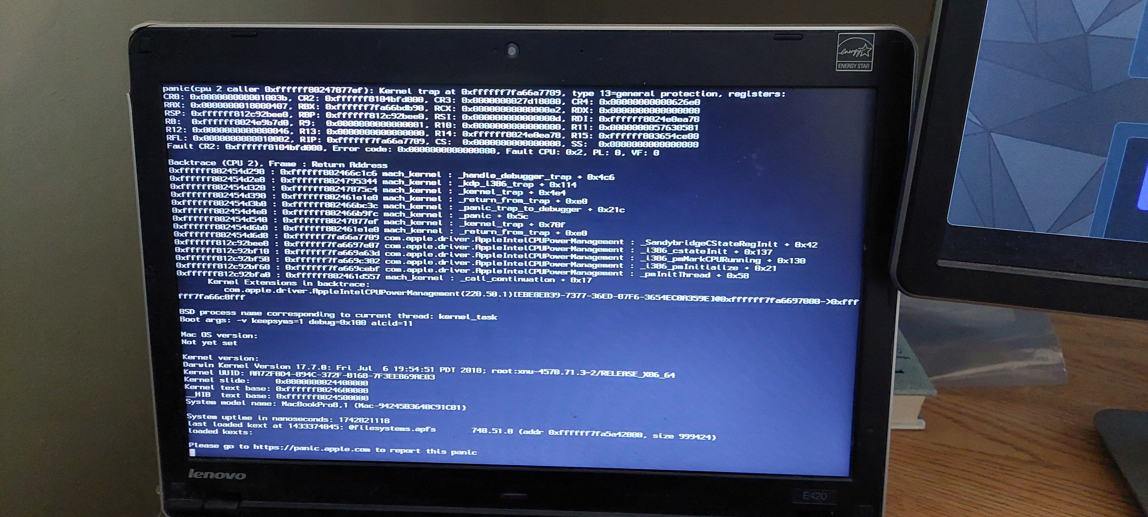

2,382
KP - Intel CPU Power Management issue.
Have you created a custom SSDT.aml for CPU power management for your Lenovo laptop?

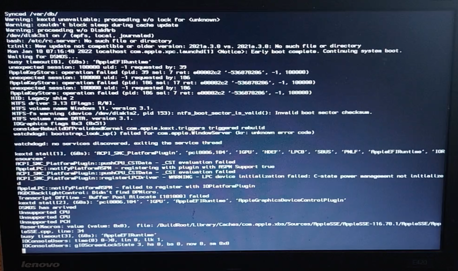

XgamesMFZB
Jan 1, 2022
18
I meant a custom SSDT.aml from following PikerA's power management method, for Pre-Haswell CPU's - # Sandy and Ivy Bridge Power Management
I have made a couple of edits to the config.plist, see if this v2 folder works any better and gets past that KP.
Sorry - I think I did those patches, considering before your reply I checked and ACPI -> Delete entries were indeed "Enabled" different than yours. That would have been ~ a year ago by now o_O
But the good thing is, I actually did not forgot to clear NVRAM on first boot this time, and then booted from USB next, and now we don't have KP :) However, we still have the blackscreen lol.
Attached is a photo of the verbose JUST before the black screen:
Here's a video of the full boot too, just-in-case (Slow - Obviously plist is on USB so) : https://mega.nz/file/BA42VRYA#9IbueeMaojb1AMMsEHflQBY05srYMwpi74LMk4QIHAE
From my Android, I saw that TeamViewer is showing Monterey connected/green, when I clicked it says "Unable to connect" lol, and minutes later says it was offline (FYI the Wi-Fi never worked on this laptop, I think it might be impossible as per SPECs (Unless I used a USB WiFi drive) so I have to use wired Internet, which I did in this case, I have TeamViewer autostart with autologin). I wouldn't worry too much as sometimes TeamViewer just doesn't log me in automatically for some reason (Would NVRAM wiping also wipe credentials? Idk).
If this help, last time I tried it (not on this plist but on my past attempts yesterday), using TeamViewer I was able to access the monitor settings and manually increase/lower the brightness, noticing the brightness was maxed out and not at the minimum (Changing brightness with the GUI slider worked, but the keyboard function keys never did, no biggie for now).
Oh, also attaching an HDMI display after the black screen has no effect (Well, unless you count a 1px white line that flashed on the laptop display and dissapeared right after connection. Unplugged the display, replugged it, and couldn't replicate the line. Nothing of interest much). Other than HDMI, this laptop has VGA but that's it, no DP or anything else (Aware VGA is unsupported I think).

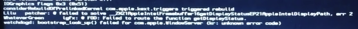

2,183
Looks like Lilu + WEG are having some issues. Are you using the latest versions?
