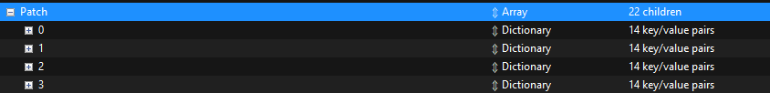

Replace the AMD kernel patches in your config.plist, as you only have 21 patches present, when the latest AMD Kernel Patches consist of 22 x patches.

I've already tried patches, but it didn't help.
