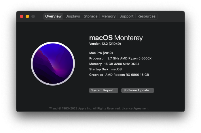

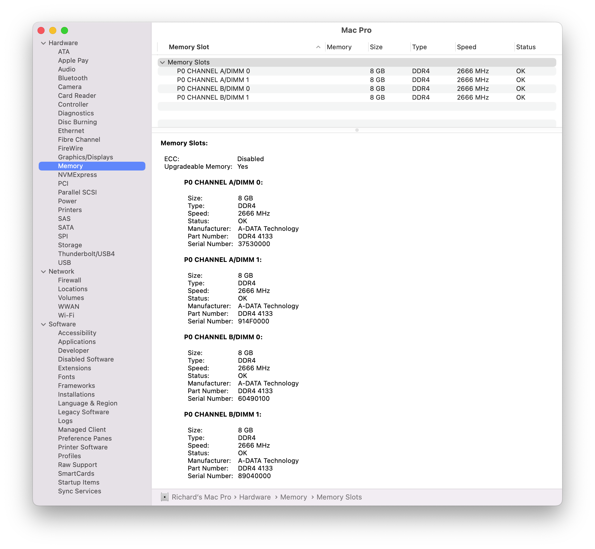

On another note, is there a way to modify the Memory Speed in the About This Mac, it is DDR4 4133, (its running at 4133 but it shows here as 2666 and its messing with my OCD)???

MacOS is probably just picking up the base speed of the memory. Does it show the correct speed in the System Information > Memory report?
4133MHz RAM is probably the speed of the memory with XMP or DOCP, as used on AMD systems, enabled in the bios.
Have you made sure this option is available and enabled in your Bios?

Yes, it is enabled in bios. Checking in system report is shows it as 2666 as well, but if you boot into windows, it shows at correct speed.
2,423
Are you using the RestictEvents.kext? Maybe using that kext might help.
Also here are methods used to change the CPU name in About this Mac (other than with the RestrictEvents.kext), which I am sure could be adapted to do the same for your memory speed, if you really want to go that far.
IIRC, you would need to disable SIP and reset Nvram, AppleSystemInfo.framework needs to be copied to the desktop before it can be edited, a new snapshot of the Monterey/Big Sur drive has to be created which includes the edited framework, you then need to make sure you boot from the new snapshot.
This to me sounded like a lot of faffing for not a lot of gain, and what gain there is only being cosmetic in nature. But in case you really want to do this here is a thread that helped someone rename their CPU - https://forum.amd-osx.com/index.php?threads/processor-unknown.1389/
