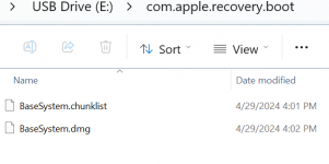

i use your EFI and it has this error
craighazan
Nov 22, 2021
344
My EFI is for an eight core APU, yours is six core. Take a look at this guide.
long08
27
thanks very much
long08
27
I followed the instructions above and it stopped here
long08
27
craighazan
Nov 22, 2021
344
That’s good, OpenCore has loaded, you just need to select which OS you want to load. Use the arrow keys and hit return.

Does the External drive contain a macOS installer, or a macOS installation? As I would expect the External drive to have a different name if it was an installer.
Post a copy of the whole OpenCore EFI you are using.
Post a copy of the Firebat's system DSDT.aml. Use Corpnewt's SSDTTime script to dump the ACPI table in Windows.

Can you two help me check to see if I'm wrong or if I'm wrong somewhere?
Thanks !

@long08
I have reviewed your EFI and Results folder and would comment as follows:
  1. Your /EFI/OC/Kexts folder is missing AppleMCReporterDisabler.kext. Your system won't boot without this kext.
  2. You don't need these two AMD Sensor kexts for installation to work, they are as likely to cause issues when using NootedRed.kext as they are to resolve any.
    1. AMDRyzenCPUPowerManagement.kext
    2. SMCAMDProcessor.kext
  3. The USBToolBox.kext and UTBDefault.kext will do nothing helpful for your system. Personally I would delete them both and just enable the XhciPortLimit Quirk in the config.plist.
    1. In order for USBToolBox.kext to work, you need to create a custom UTBMap.kext (in Windows), which contains the discovered and active USB ports.
    2. The UTBDefault.kext is used while configuring your USB ports, it isn't a working USB configuration.
  4. Your /EFI/OC/Resources folder is empty, bar some holding folders.
    1. You should use a populated Resources folder so you aren't restricted to the OC (Text) Picker List boot screen.
The rest of the EFI content looks OK.
Config.Plist:
  1. You have failed to add the 5 x ACPI patches that were created when you used Corpnewt's SSDTTime script, i.e. the HPET patches are missing.
    1. The SSDT-HPET.aml table will not work without the patches.
  2. You have not enabled the DummyPowerManagement entry, which is required for AMD CPU's.
  3. I have enabled the Kernel > Quirks > XhciPortLimit entry, as your previous USB configuration was pants.
  4. I have changed the Misc > Boot > LauncherOption from Disabled to Full, so an OpenCore entry appears in your Bios Boot list.
  5. I have deleted the Serial > Custom section, as your Mini PC doesn't contain a Serial Port.
  6. I don't know if you have changed your bios, so you have Above 4G Decoding enabled.
    1. As this is an unknown factor, I have added the 'npci=0x300' boot argument to your config.plist, as without one or the other your system won't boot.
  7. I have cleaned up the config.plist, removing a number of unused entries, so the config is easier to read and navigate.
Try this revised EFI see if this gets you any further. All you need to do is rename the EFI-v1 folder as EFI.
Before booting the macOS installer, make sure you use the ResetNvram driver from the OpenCore boot screen. You will need to press the spacebar to unhide the drivers in your OC setup, then select the driver. The system will reboot automatically and at the same time remove any old NVRAM entries, so your system just boots with the new settings in the revised EFI attached.

image.jpgThank you so much, it worked. I will save your analysis, it is very useful
