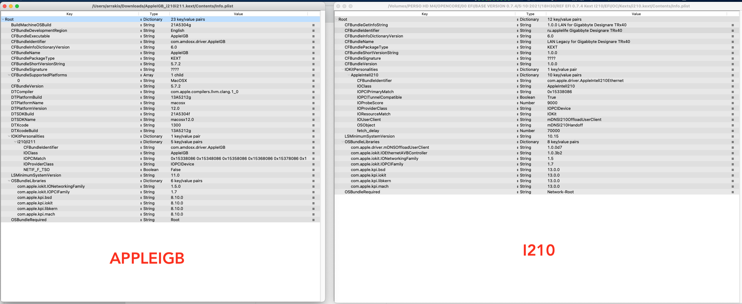

Once the problems with SmallTree and Monterey. I have found this kext to work wonderfully for Monterey since Beta 7 and Big Sur too. (Intel I210)
  • i210.kext.zip
isn’t that the AppleGB kext with a rename? LOL

I don't think it's the same kext.

It is not specific to the TRx40 for proof this link. it must be modifiable for your platform.
Nice one thank you but this would of been useful info to start with instead of just posting the kext and claiming it works. If future it would be very helpful explaining something fully so people understand straight away. 👍

2,190
That's purely an injector kext which does nothing for the I211-AT. Even with the device ID added to the plist.
