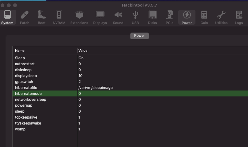

its weird tho, I installed v070 copied and pasted entire EFI folder and edited the config.plist to correct platform id, reset NVRAM after that.
Now the system reboots instead of shut down when I click shut down from menu.
Have you enabled ERP in the bios or anything like that Or have you got some kind of USB Hub connected to your system?

what's ERP? I followed your BIOS setting and it was fine in 0.6.9
Your the only user with that problem so it can’t be on the EFI side TBH.
Erm, Try clearing your NVRam and check your power settings in hackintool
