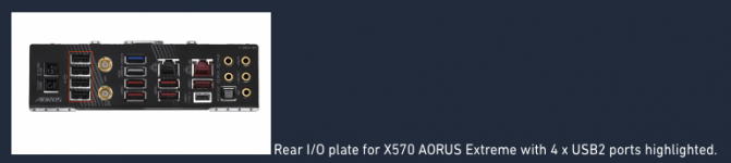

You will be making another mistake if you change ALL the USB2 ports to (0).
  1. Only 4 x ports on your motherboard, the four black tang ports on the rear I/O plate, should be set with connector type USB2 (0). These are the four ports I highlighted on the rear I/O image in post #6.
  2. Any USB2 virtual ports, i.e. not USB2 physical ports, should be set to match the physical aspect of the port it is served from.
  3. So, if you have a USB3 or Type-C port/header that provides a virtual USB2 port, that virtual USB2 port should be set with the same connector type as the Physical connector, i.e. USB3 (3) or Type-C+Switch (9) or Type-C without switch (10).
  4. Under no circumstances should you set the connector type for a virtual USB2 port as USB2 (0).
  5. Only the USB header F_USB1 and USB port from the M.2_WiFi connector should be set with a connector type 'Internal' (255), a maximum of 3 x (255) ports if all are used.
  6. The 2 x USB3 headers, which can provide up to 8 x ports (4 x USB3 & 4 x USB2 (virtual)), should all be set as USB3 (3).
1. First of all, that 4x USB2 ports on the Backplate:
Those are showing as single USB2.0 Hub. Corpnewt tool indicates that any 2.0 device I plug in it shows it under this Hub. I remember there was a past thread discussion similar to this case and was instructed to set it as type number 0.
2. I'm understanding that any "physical" USB 3 ports that supports reading USB2.0 devices, are called USB2 virtual ports, and they need to be type 3. So those ports, I'll revert applicable HS to type 3.
3. USB-C are remain set as type 9 for both applicable HS and SS
5. M.2 WiFi or bluetooth? (Intel Bluetooth USB address) That is set to 255

2,394
Having reviewed the information you provided and making some educated guesses, I think your USBMap.kext should contain the following.
Motherboard XHC0 ports.png Motherboard headers and built-in USB ports - XHC0 controller
Rear I-O-XHC2-XHC3 ports.png Rear I/O plate ports XHC2 & XHC3 controllers
A revised USBMap.kext is attached for you to test. Port mapping amended to match port connector types listed in images above.
