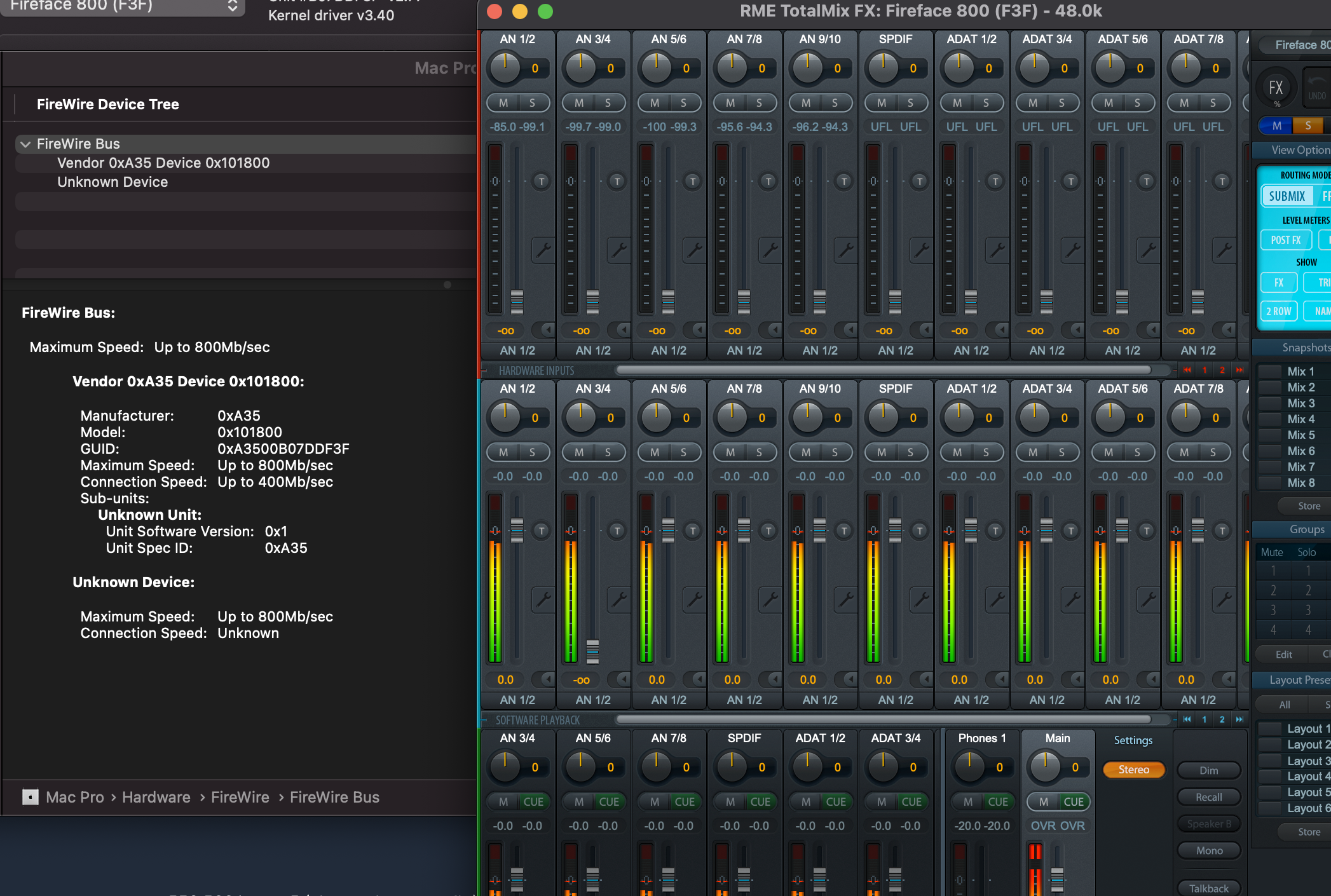

Hi there! First Post! I recently test updated to Big Sur, everything is working, expect for my firewire audio interface, which is unusable. :)
Gigabyte Aorus Master X570 Bios F30
Amd 3950X
Sapphire 5700xt
Firewire card: StarTech PCIe 1394b
I am using pretty much olbos latest config: https://forum.amd-osx.com/index.php...c-0-6-5-gigabyte-aorus-master-x570.523/page-5 (just changed ram config)
Internal and hmdi audio is working fine.
Fenvi pci card works.
I removed the rme kext and reinstalled it completely, sip is turned off.
It is not showing up in pci cards in the mac os panel, as is the fenvi card, but it is working. So i guess this can be ignored.
Everything is working fine in Catalina.
My next logical step would updating to the latest oc version.
If anyone has an idea or can point me in the right direction, i would be very grateful!
Cheers!

Have you installed the drivers for Big Sur? Seems like the older versions will not work so newer ones are required, https://rme-audio.de/downloads/driver_fw_mac_340.zip
Yes, you can see in the first picture (top left) that it is running v 3.40. I removed it many times manually, reinstalled them, added rme as trusted developer, etc.
Basically the driver installs fine without any modification on a clean install. It gets recognised by OS X and the "allow" in security settings pops up on a new install even with sip enabled and not using the trusted dev list as mentioned here: https://forum.rme-audio.de/viewtopic.php?id=30462
The communication to the fireface works and always has. I can control the preamps, settings, phantom power, word clock etc.
Just the sound is a noise blast an all output channels.
Tried 400 and 800 cables, no difference.
I think something with the timing of stream might be wrong but I have no knowledge of how this things should work. (rechecking kernel patches and ram settings would be a guess, and just a guess, and I cannot confirm nor deny any problems with the ssdt's, because I have never built one myself and used the ones by olbo)
