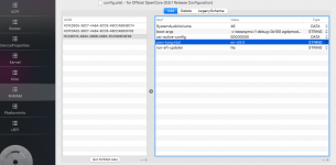

Yes @Zhenxin. Just delete this line highlighted in blue in the EFI config.plist file. Delete the line then save the file and reboot the system.
This line is used to define the installer assistant language. Deleting it should allow you to select the language you require in the installer >

Okay in that case I think maybe we could try to add the country value back in another way?
I did a search online and think you need the following added under NVRAM > 7346110-AB2A-4BBB-A880-FE41995C9F82 for Chinese:
Key: prev-lang:kbd
Value: zh-Hans:252
Type: String
