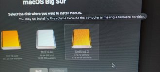

You may not install to this volume because the computer is missing a firmware partition

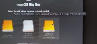

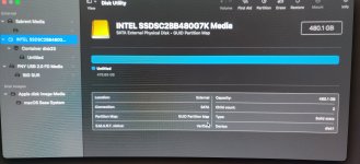

Not sure why im getting this when selecting the hd to install. Ive tried both apple format with partition man and os extended jornal with partition map get the same result.
Side note. I had Cat installed and working on the drive. It is a SATA drive. Is this maybe the problem? What files from me do you need to help diagnose.

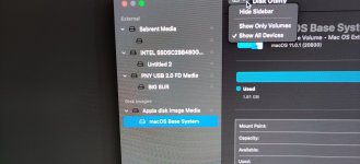

Sounds like you are only formatting a partition. You need to format the full drive.

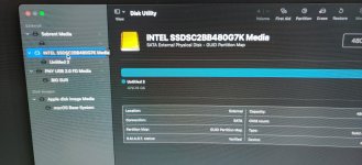

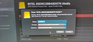

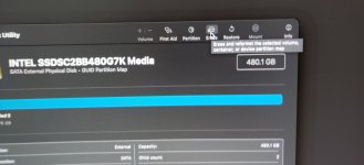

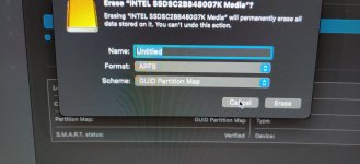

i did. i clicked show all so i could click the drive itself. then i clicked erase. and i was given 3 drop downs. i thought i was supposed to see 4 but i cannot remember.
2,181
GUID Partition Map?

Ill do it again right now and take pics with my phone and attach them. give me like 5 mins.

GUID Partition Map?

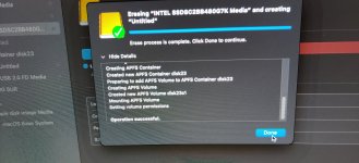

Ive tried apfs guid .. journaled guid and always ends the same. If i dont pic a guid it dont tell me its missing firmware. but then it says missing guid lol. /bangs head.

Ok i just tried it too with 0.6.3 and get the same result.. was soo easy when i did the catalina install not sure why big sur is so hard :( ill attach my config.plist

OK i figured out out. Well i used to never have above 4g decoding in my bios. But with im not sure what update it got put there. I turned that on in bios removed the boot arg for pcie 2000 thing. Also saw that my serial port got turned back on so fixed that. And also had to fix from other to ueif on os boot. After i did all that i was able to install big sur. Not finished setting it up. Ill work on that later since im tired. But not sure which one fixed the issue i was having.
