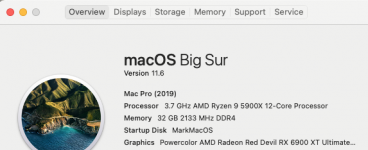

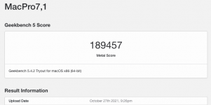

I stole AudioGod's EFI and added a couple of lines to get the RX 6900 working.
