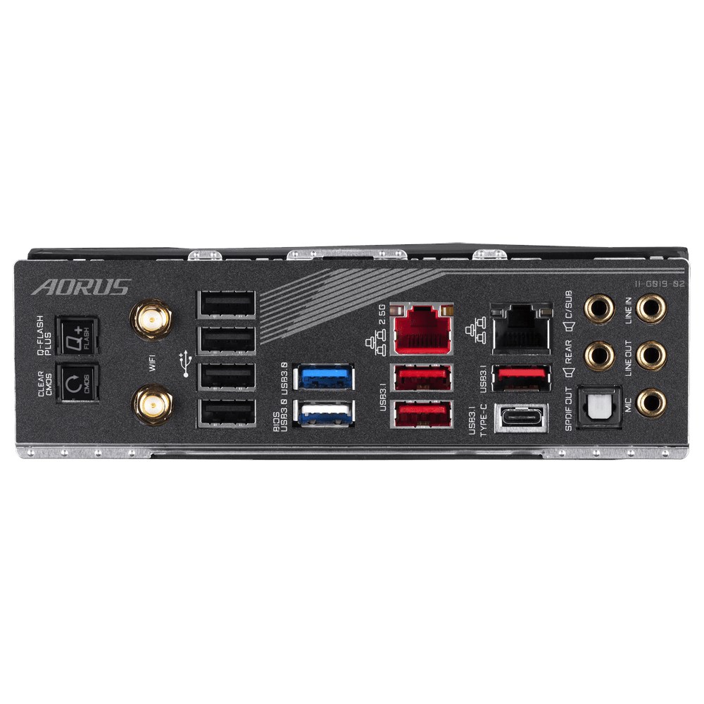

@AMDPUSH I don’t know you know.
The layout on the schematics look the same to me.
even the io plate has basicly the same layout.
It looks like a match to me.
