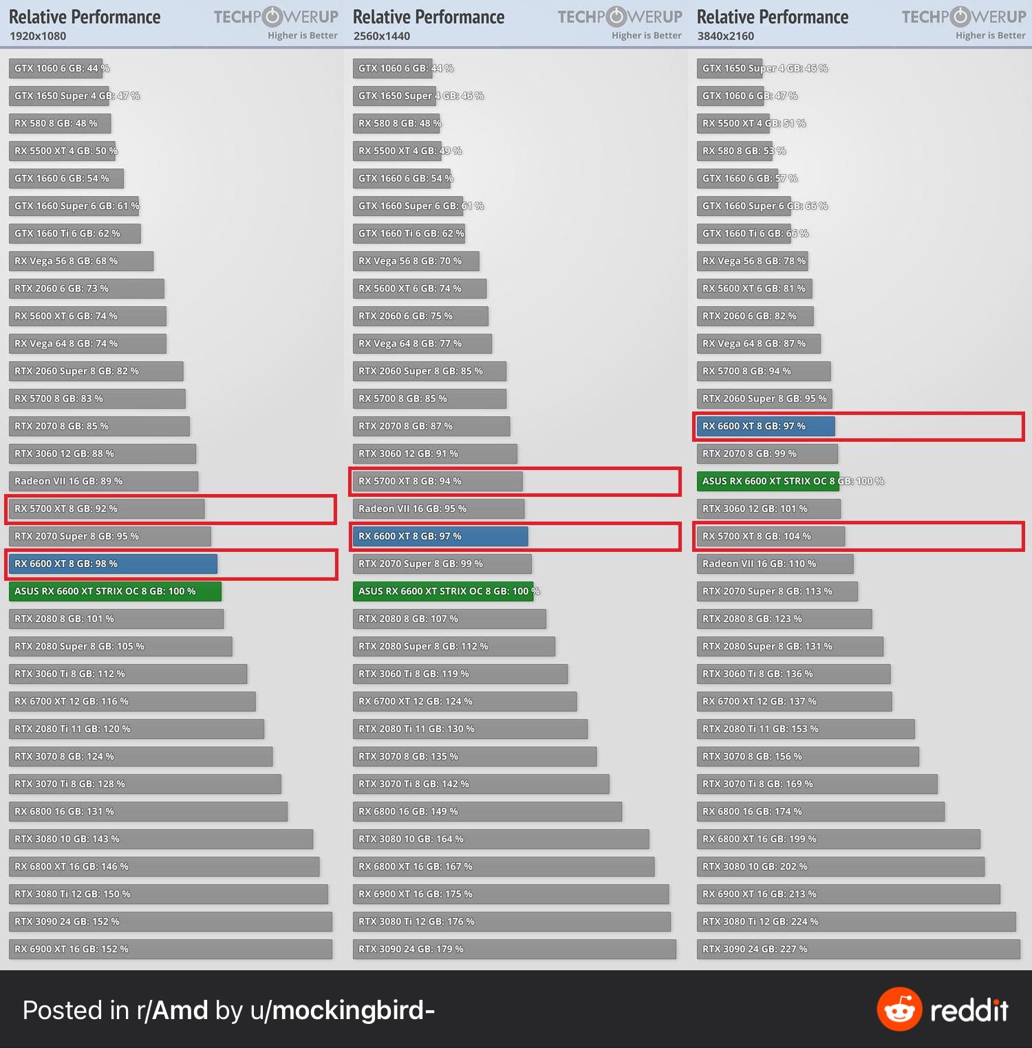

Its trades blows with a 5700 XT.
savage001
Jun 4, 2020
180
Thanks for that. So at 1440p it shouldn’t be too bad and still a definite upgrade from a RX580 8G.
