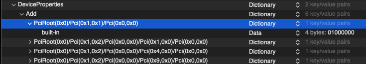

hello I have another problem
is the nvme hard drive recognized as external?
opencore 0.8.4
msi b450 tomawake max

2,343
opencore 0.8.4
That's easily fixed. You can use device properties in your config like in my screenshot below. Right click the device in Hackintool and copy Device Path.
