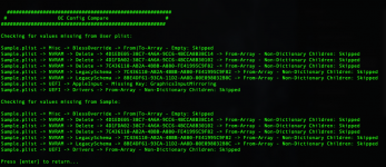

I was watching the OCconfigCompare and after comparing my config.plist file and have found a series of shortcomings, I compared the sample.plist file of version 7.1 (with which I did my confing.plist) with the new reference one.
When I updated my folder, I updated the openCore file with all the files in the various directories but I have not redone the confing.plist file.
I came a doubt: when I update my EFI folder, I have to also redo the confing.plist file taking the new version?

@Pulsar You have two options: take the new sample config and copy over your settings from the old one, or take your old config and adapt it according to the Differences.pdf that comes with OC.
(If you skipped more than one version you'd have to get the Differences.pdf from each version you skipped too).

Ok. Sounds good. Is there a way to copy the new sample over the old one while keeping all the changes I made earlier? I don't think it's to be recompiled in full.
