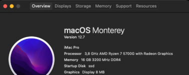

I was able to boot into the operating system, but the integrated amd graphics still don't work
1,965
What changed to allow you to boot in to Monterey?
Have you checked the Integrated graphics are set correctly with the correct/sufficient amount of VRAM in your bios. i.e. minimum of 1GB?
1,965
Have you got any entries in the DeviceProperties > Add section in your config.plist? As having any entries in this section of the config is known to mess with NootedRed.kext.
