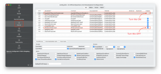

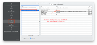

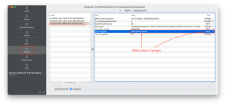

I've made some changes to your config.plist as shown below. Please copy serial numbers into PlatformInfo -> DataHub and then try booting with this config.plist.
Screenshot 2025-07-10 at 9.42.29 AM.pngScreenshot 2025-07-10 at 9.44.48 AM.pngScreenshot 2025-07-10 at 9.46.53 AM.png
