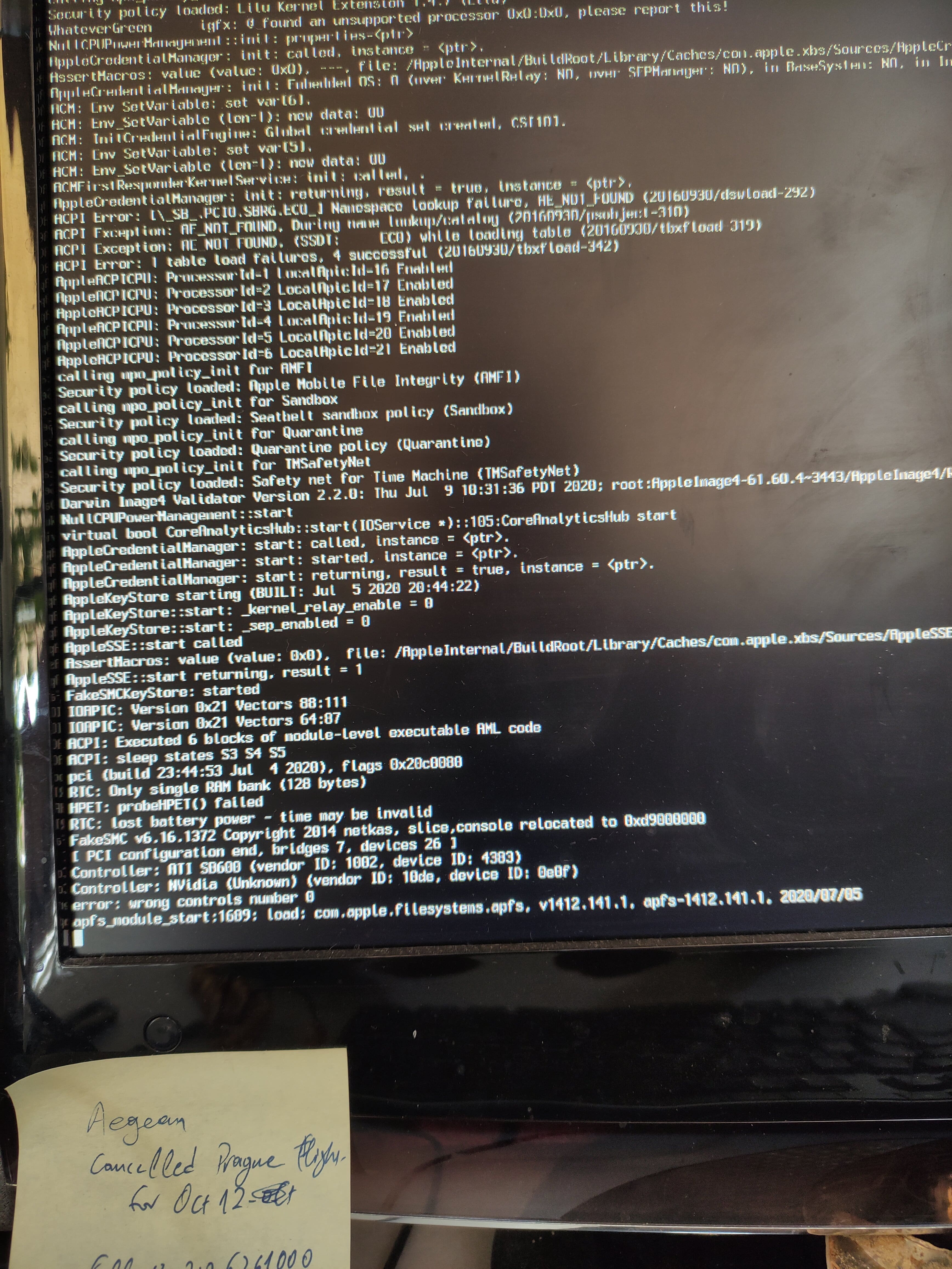

I managed to create a EFI with all the necessary SSDTs and kexts and a config.plist with the proper(?) settings and the new kernel patches that boots normally up to a point but then it gets stuck at the point "apfs_module_start:1689....".
Anybody got any ideas of what is wrong or how to solve it?
I attatch the screenshot and my EFI

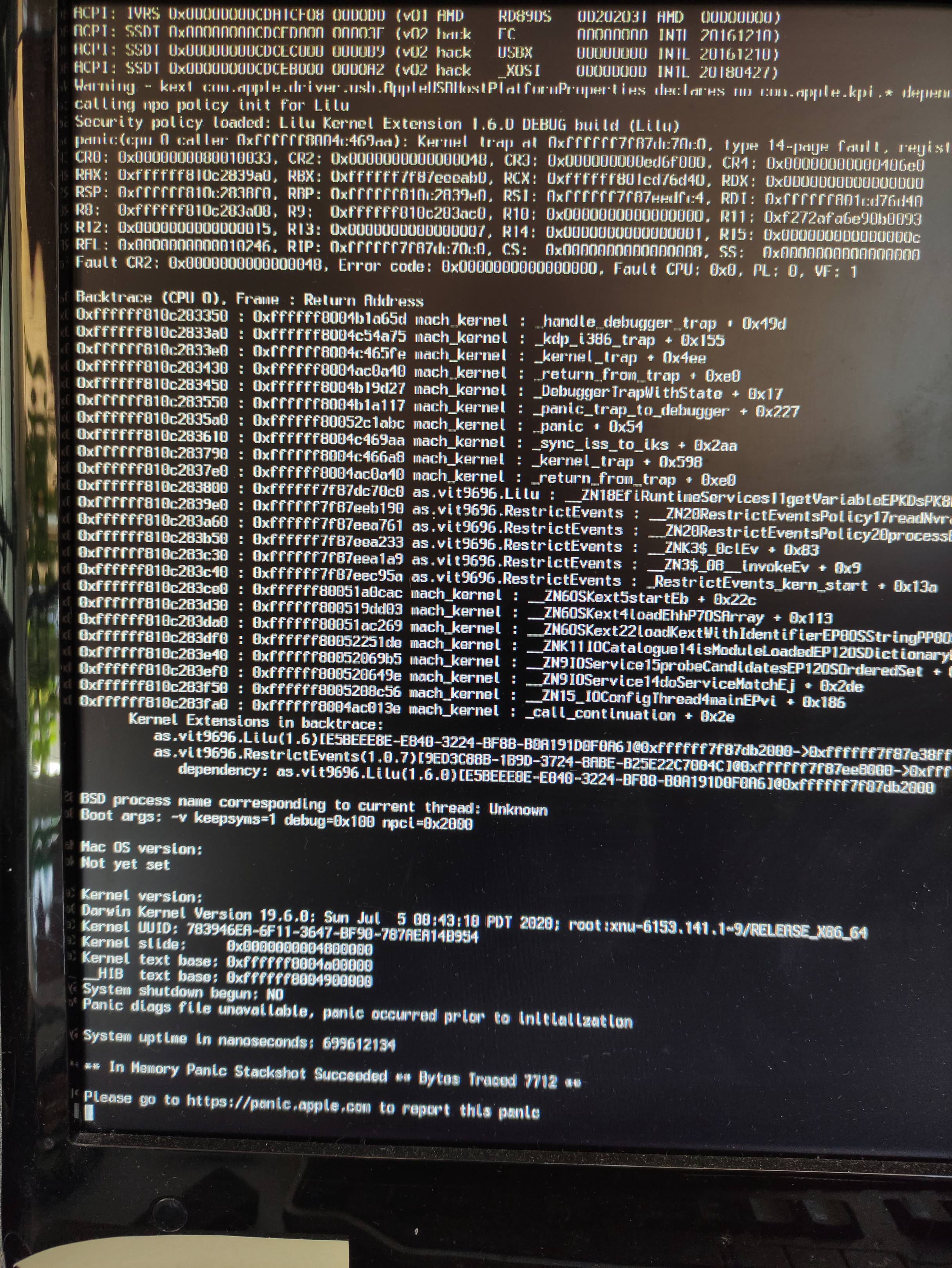

Thanks a lot for your help but your EFI didn't work. The first attempt, using the specific EFI, was complete failure. It did not even boot into Opencore. Then I changed a few parametrs in config.plist and managed to boot into Opencore and it displayed the picker menu. The chenges I had to make in config.plist in order to boot into Opencore were "USEFI -> APFS MinDate -> -1, MinVersion -> -1" and "UEFI -> Quirks -> UnblockFsConnect -> True". When I picked the Catalina experiment disk for boot it ended up in kernel panic. See the attached screenshot.
