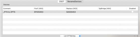

This SSDT is also looking in the wrong location, so it is not working for your AMD system. Your CLOVER/config.plist is also missing the accompanying ACPI Rename patch, which is required to make this SSDT work.
Screenshot 2022-04-07 at 20.28.34.png ACPI rename patch required for SSDT-FixShutdown.aml to work

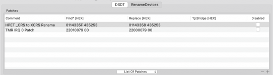

I have taken the liberty of running the SSDTTime script with your system DSDT.aml and have attached a copy of the Results folder generated. You should use the 2 x SSDT's in the folder and add the two Clover patches to your config.plist.
Screenshot 2022-04-07 at 20.43.00.png HPET& IRQ rename patches generated with your DSDT.aml.
View attachment 5607 ACPI rename patch required for SSDT-FixShutdown.aml to work
View attachment 5610 HPET& IRQ rename patches generated with your DSDT.aml.
