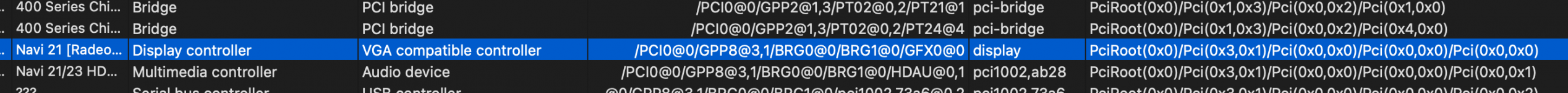

- Launch Hackintool and get the IOReg Name and Device Path of the GPU (PCIe Tab)

* Modify the 3 followings line with the information found in the IOReg Name /PCI0@0/GPP8@3.1/BRG0@0/BRG1@0/GFX0@0.
* Save it, the PCI Bridge is done
