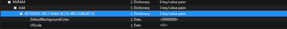

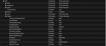

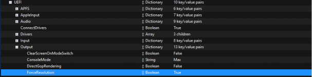

Hi all,
I will keep it breif a small issue that I am not to fussed to sort but would just help me out a tad. So with Opencanopy setup my OC Boot Picker will not allow any resoloution greater than 1280x1024.
I am using a 3400x1400 display so I would'nt mind being able to use the whole screen resolution. Below is the debug information for this issue.
02:489 00:003 OC: Requested resolution is 3400x1400@0 (max: 0, force: 1) from 3400x1400
02:493 00:004 OCC: Missing OcForceResolution protocol - Not Found
02:497 00:003 OCC: Requesting 3400x1400@0 (max: 0) resolution, curr 0, total 7
02:501 00:003 OCC: Current FB at 0xE8000000 (0x800000), format 1, res 1280x1024 scan 2048
02:505 00:003 OCC: Mode 0 - 1280x1024:1
02:508 00:003 OCC: Mode 1 - 640x480:1
02:511 00:003 OCC: Mode 2 - 800x600:1
02:515 00:003 OCC: Mode 3 - 1024x768:1
02:518 00:003 OCC: Mode 4 - 1280x720:1
02:521 00:003 OCC: Mode 5 - 1280x800:1
02:525 00:004 OCC: Mode 6 - 1280x1024:1
02:529 00:003 OCC: No compatible mode for 3400x1400@0 (max: 0) resolution
02:532 00:003 OC: Changed resolution to 3400x1400@0 (max: 0, force: 1) from 3400x1400 - Not Found
I am a little stumped as I have heard of disabling mutiple BIOS Settings such as CMS and other Legacy Support that may affect disaply resoloution on boot but this has been to no availe.
Thanks taking the time to read.
