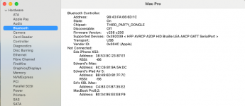

For the Intel Bluetooth you need to add three kexts, in the following order.
IntelBluetoothFirmware.kext
IntelBTPatcher.kext
BlueToolFixup.kext

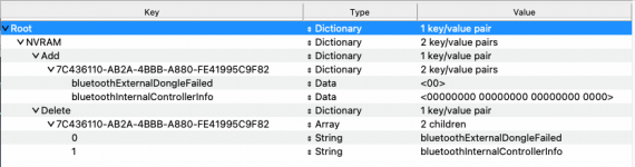

Plus these NVRAM entries are required in the config.plist.
The Config-Intel-BT.plist attached below contains the necessary Bluetooth entries.
Plus of course the USB port that the Bluetooth module connects to needs to be active, enabled and set with the correct Connector Type (Internal/255) in your USB kext.
