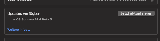

14.5? The latest is 14.3.1. Beta is at 14.4 so I'm confused what you mean. How are you trying to download and install? Via the app store?

sorry please...I meant 14.4 beta 5...Bildschirmfoto 2024-03-02 um 11.46.33.png
I'm just trying 14.3.1
