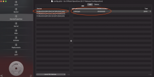

You could enter them under NVRAM/XXX-XXXX-XXXXXXXX (There are 3 codes, choose one of them, it should be an option called Boot Args.
shikigva based on your config (=80 if using iMacPro1,1 =128 if using MacPro7,1)
Also, you should add:
unfairgva (for fixing Apple TV Green Screen)
This should be added to your GPU Device Properties (you can find it in hackintool (PCI Devices))

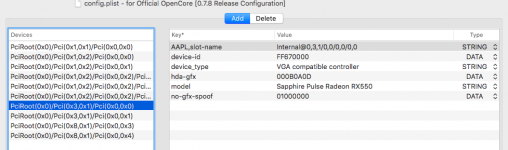

Try this setting under Device Properties. And btw it is -racodec not -radcodec
thank you middleman i did by your advice but still not working. so i upload my EFI. please check if i something wrong with my config

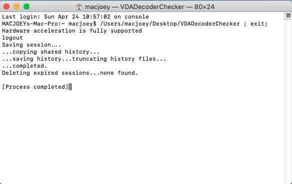

Mojave and i only see ResetNVram with your EFI so i change Mindate and MinVersion to -1. then i see my DRIVE but still not boot
and I use VDADecoderChecker. it said Hardware acceleration is fully supported. but in VideoPROC still no H264 and HEV265
Okay got it. For Mojave if you add shikigva=128 or shikigva=80 in the NVRAM boot-arg, it should now work.
