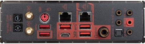

For me, I have the MSI MEG X570 GODLIKE. Here is the Back IO
with a traditional set audio jacks(right part,5 3.5mm and 1 S/PDIF) and another 6.3 mm headphone port.

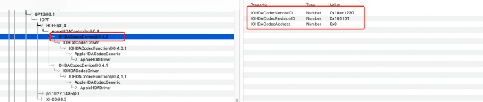

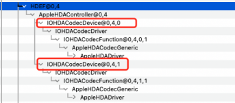

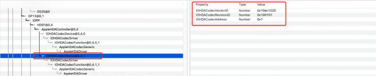

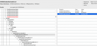

IORegistryExplorer also shows two alc1220 clearly.
