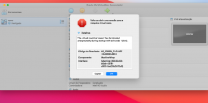

In parallels, I can't print because it crashes the computer.
the following message ´the performance of the virtual machine may be affected because the virtualization package has been disabled on mac´
Can anybody help me ?

Parallels uses the Apple Hypervisor which won't work on AMD. For VBox make sure you're using the latest version for Big Sur and the kexts have been approved in the System Preferences.

I managed to run the parallel, virtualization was disabled in the bios, but it is crashing a lot .. the virtual box is not starting the kext has been approved in the system preferences

Uninstall VBox using the tool provided. Open Terminal and run sudo csrutil clear.
Reboot and install VBox again, then approve the kexts and reboot. Now try it again.

Getting the virtualbox to work thanks
here the video memory size is limited to 258 mb, how can I increase it?

That's a limitation of VBox. I don't think there's a way to increase it.
VirtualBox said:
VirtualBox doesn't use the GPU. Not directly. It has no access to the GPU's memory. What you see as graphics RAM in your VM is actually plain, normal RAM from the host, not from your GPU.
