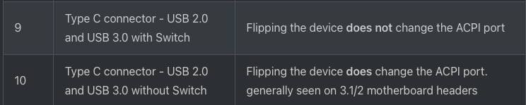

I noticed that you only have one Type-C port defined, there are usually two ports (USB3 & USB2) defined on a Type-c connector.
Also as you only have one port set with the connector type 10 (Type-c+ Switch) how do you know it has a switch?
These are the two options when setting a Type-c port.
It is as likely that the Type-C port on the rear I/O plate on your motherboard is a Type-c (9) connector. Assuming you tried the test where you flip the USB Type-C device 180° and reinsert it, to see if the port designation changes.
