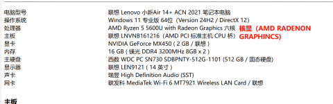

- CPU:
- AMD Ryzen 5 5600U with Radeon Graphics
How difficult is it for AMD users to customize the EFI manually?
Let me tell you about my failed steps instead:
1. I used Hardware to generate the ACPL(.aml files).
2. I used the OpCore-Simplify to generate the EFI for this machine (this open-source project is great; unlike RapidEFI, it can recognize the hardware type and generate an EFI almost as customized by hand).
3. I downloaded the Nootedred.kexts from the official website (they were originally included in the generated EFI, and I was worried they weren't the latest version; I updated them), and adjusted the order of the kexts.
4. I partitioned the space, dragged the EFI into the ESP partition, and successfully entered the Mac 26 installation.
5. During the installation, I encountered the problem that the 200G partition I prepared couldn't be erased. I tried many times, and finally, in DiskGenius, I formatted this partition into the MacOS X (HFS+) partition format to be able to erase it as an APFS format and proceed with the installation.
6. The installation process went smoothly, but when the installation was completed and entered the mac , problems similar to those in Figures 3 and 4 .
Could you help me?
