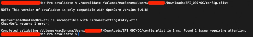

I am getting the below error while validating with ocvalidate tool.
NOTE: EFI_097 is my older folder where I made changes for OC 0.9.8

Remove FirmwareSettingsEntry.efi and OpenVariableRuntimeDxe.efi drivers. You shouldn't need either with an X570 board.

@Edhawk Thank you for your correction. After removing both drivers, I'm able to boot my machine with OC 0.9.8.
Did you update the drivers when you tried to update to 9.8? It seems to be saying the version you are using is from a previous version of Opencore, probably 9.7Openruntime.png

Did you update the drivers when you tried to update to 9.8? It seems to be saying the version you are using is from a previous version of Opencore, probably 9.7View attachment 13298
YES, I already mention this below in my post.
