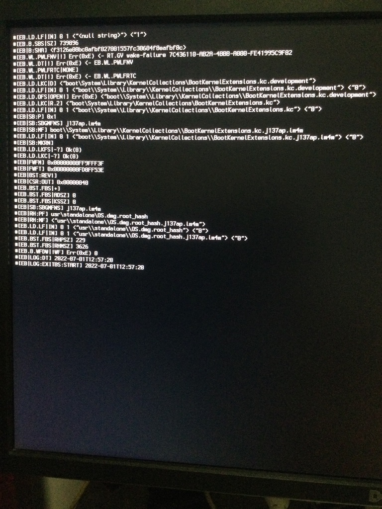

adrianz
Jul 1, 2022
@Edhawk, Hi , I have same MSI MEG B550 UNIFY board, and a NvME SSD which has Big Sur 11.6.5 installed (I installed OS on a Intel H270 machine, leave EFI partition blank so I can try different EFI on a flash disk). I'v tried both of EFIs you uploaded, both stuck at like attached picture. Would you please give me some clues? Thank you!​
@54thC , would you please share what you did with those uploaded EFI so that you can install Big Sur successfully? Thank you!
910
@adrianz which CPU are you using? Is it a 12-core CPU, as that is what the config.plist in EFI v2 is set to patch.
If you have an 8-core or 16-core CPU, then the first three AMD Patches in the Kernel section of the config.plist need to be edited to work with your CPU.
Another issue might arise if you have Enabled Above 4G Decoding in your Bios. If that is the case then you won't need the npci=0x2000 boot argument, which I added to the config.plist.
You will also need to use a different Serial Number, MLB, ROM and SystemUUID, if you are looking to use the EFI v2 attached in post #13.
Otherwise the EFI should be good for a B550 motherboard running macOS Big Sur.
