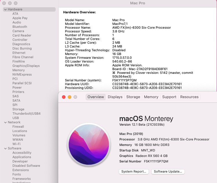

1. Unable to update to Monterey 12.1 betax from 12.0: It's Macintosh HD always got reboot loop. The only solution is got updated Macintosh HD from other hackintoshs, then it can reboot 3 times successfully to newer version.
[Solved] Please see my post later dated on 2021-11-22.

[Solved on 2021-11-22]
The first issue was solved by the following method: (1) OpenCore 0.7.5 (2) SMBIOS=MacPro7,1
(3) SecureBootMode=j160 To get updated Macintosh HD at first
(4) SecureBootMode=Disabled To reboot for 3 times and complete update process without reboot loop now !
I don't know why using the similar method of HWTarget in Clover 5142 did not work for me.

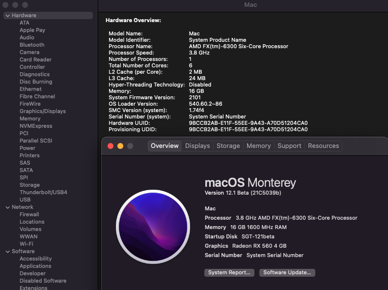

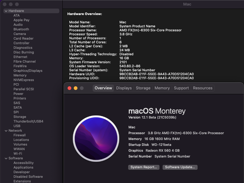

[New finding]
I just found and confirmed that my FX-6300 hackintosh can update successfully by the following simpler method too:
(1)OpenCore 0.7.6
(2)SMBIOS=iMac17,1
(3)SecureBootMode=Disabled To reboot for 3 times and complete update process without reboot loop now !
