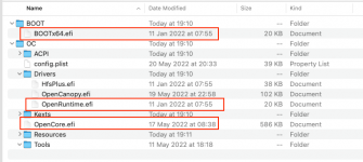

Something that has me a little concerned is the mismatch in the dates of the BOOTx64.efi. OpenRuntime.efi and OpenCore.efi files. They should all have the same date, if they were taken from a single OpenCore release, which is essential for OpenCore to work.
Screenshot 2022-06-01 at 19.36.33.png Mis-match on dates highlighted
