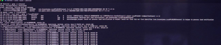

Hi everyone! Thanks for the replies!
Well, I tried a few other things, even recompiling the kext, but it still didn't work. I looked through the logs, and I think the kext simply can't wake up the card.
you can try blocking appleethernetrl in kernel
Yes, I tried that too, unfortunately, it didn't help.
Here are some photos that I hope will help you find the source of the problem. If you need any other logs, please let me know, I'll be happy to provide any information.
