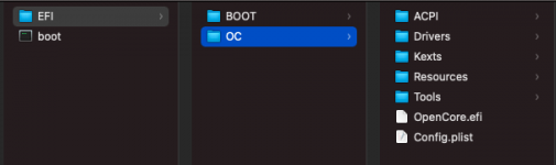

Currently on OC 0.6.3 and trying to upgrade to 0.7.4 but can't get it to boot - it seems to crash and reboot at random points in the boot process or soon after it's done booting (one time I managed to sign in and open an app before it crashed).
Another issue is that I can't update big sur from 11.1 (it reboots into a new boot entry "Macintosh HD" and gives [EB|#LOG:EXITBS:START]). I assume this is because of a broken seal, and the recommendation is to upgrade OC to >0.6.4.
Old and new EFI attached
